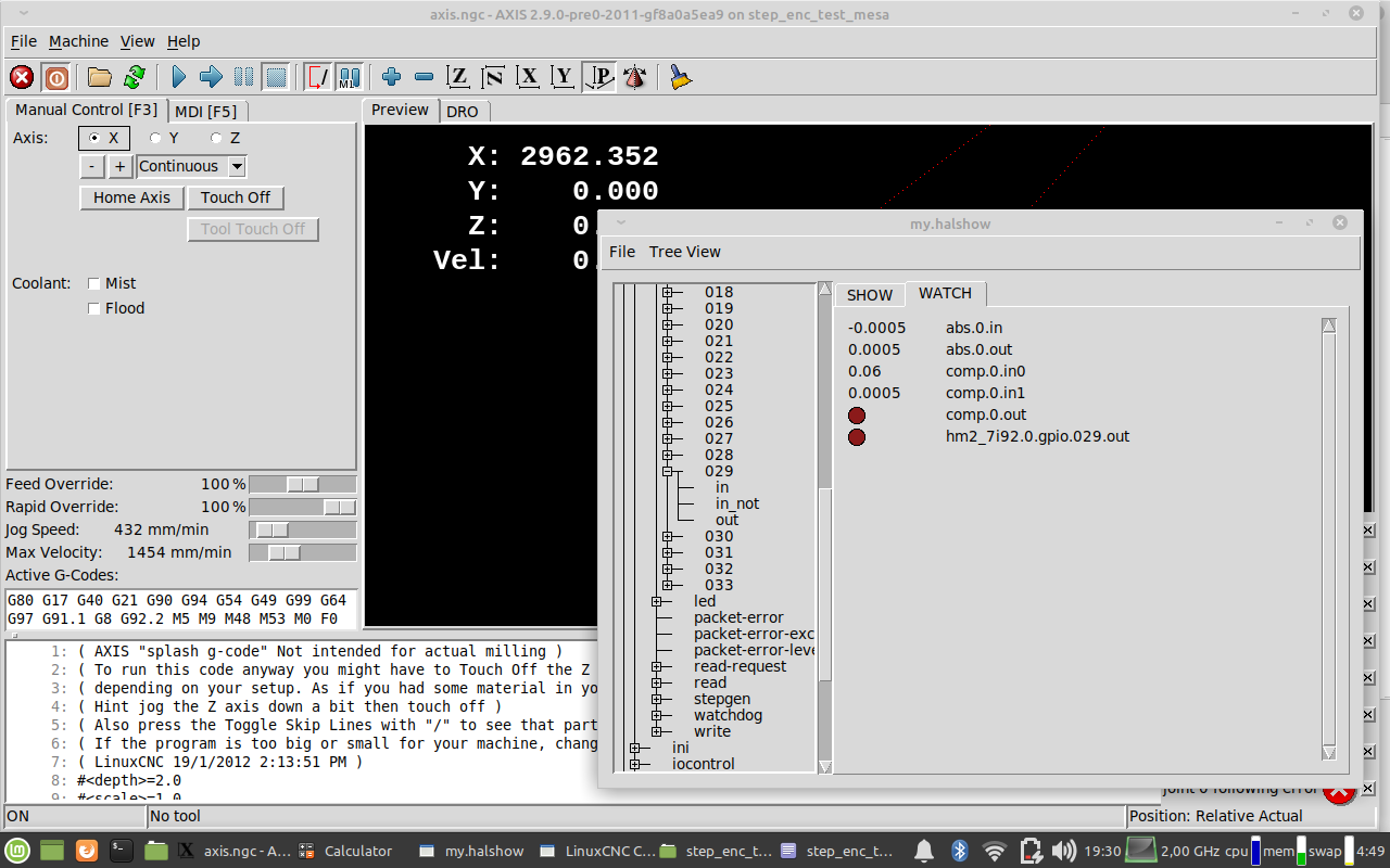

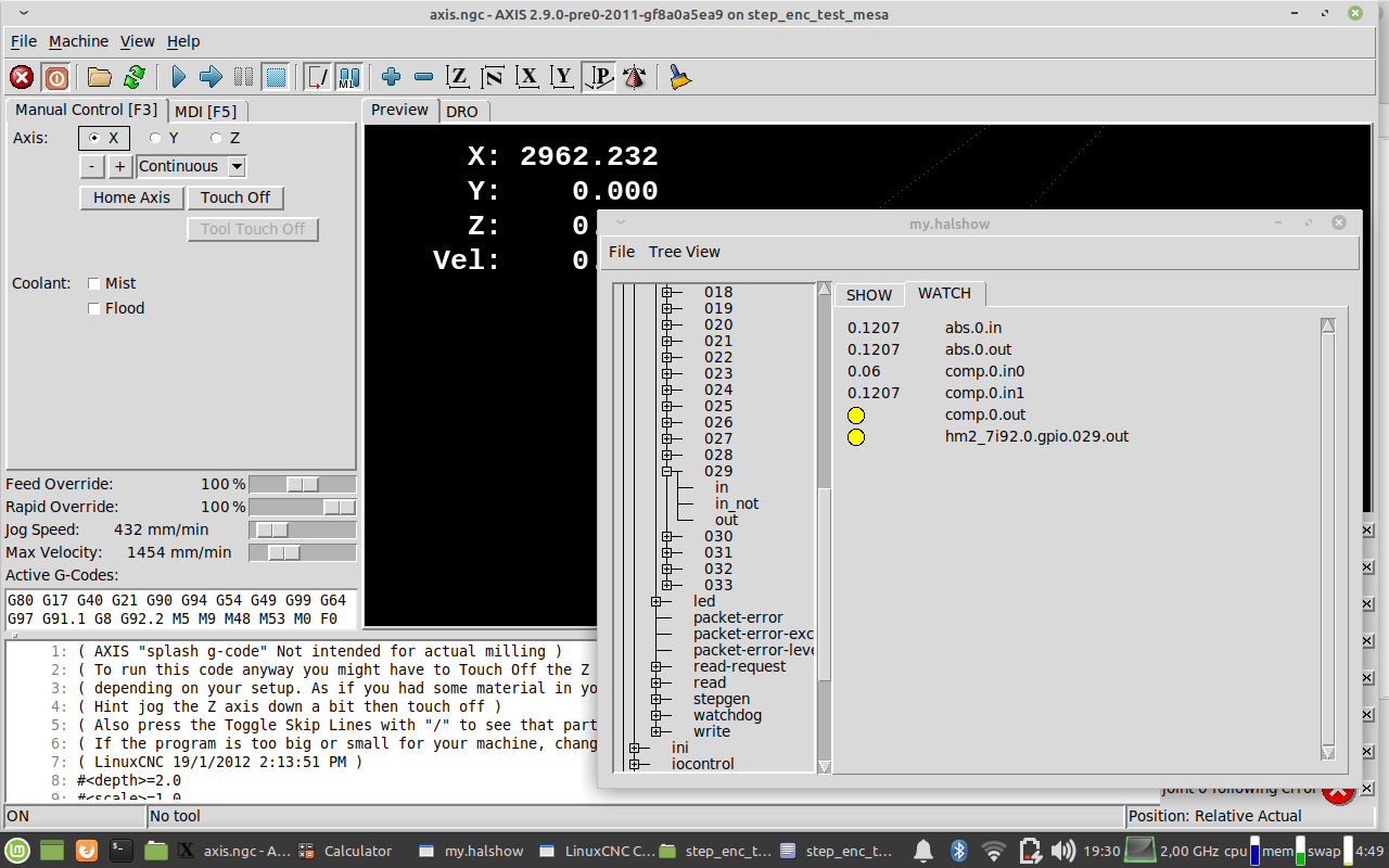

This article pertains to Lam Technologies stepper drives, namely the DSxxxx series of them that feature a "Boost" input, giving the possibility of adding more current to stepper motors when the f-error passes a certain settable threshold.
Note : Lam drives come factory set to invert the boost pin, so when that pin goes high the current is lowered to the motor by a value preset in the drive, the default is 50%.
In this example i used a DS1044 set at 2A, so with the boost active that drops to 1A. In the config attached, the output pin that controls the boost feature is inverted, so in normal use there is 1A going to the motor at standstill and while moving and the f-error is under the preset value, while it jumps to 2A as soon as that threshold is exceeded, offering more power for the motor to correct the position.
The f-error value is sent through an ABS component to have only positive values derived from f-error values, then to in1 of a COMP (comparator) with the in0 set to a value of 0.06 (that reflects to 0.06mm of positional error) and the hysteresis set to 0.05. The output of the comparator activates the physical output on the Mesa 7i92, consequently the Boost input on the DS1044 goes low, resulting in 2A going to the motor till f-error drops below the set value of 0.06 when the output is pulled high and the motor current drops to 1A.
Other settings and equipment used for this test:
Drive microstepping 16, 2A Nema23 stepper motor with a 2500PPR encoder slapped to it giving 10000 counts per motor revolution, Mesa 7i92, encoder wired directly to 7i92 inputs, Linuxcnc V2.9.
The attached config has only X axis using encoder as a general idea.
Note the P value for the PID loop sets how fast the motor will try to correct it's possition, so the lower it is set, the better chances of restoring position. At default 1000 P value the motor will not be able to correct the position due to high speed, but that value is very dependant on the scale used, so a bit of testing is required.
On the below pictures:
Motor at standstill, error is under the threshold, Boost output is not active:
Motor forced out of position, error over the threshold, Boost output is active:
Regards,
Tom.
