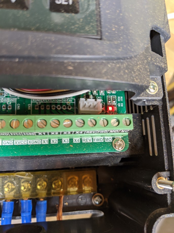

Thought I was getting a huanyang VFD, but it turned out it be a yalang yl620 that uses a different command set apparently. Anyone talk to one of those over modbus from LinuxCNC? The modbus pins are the JST-XH connector right above the FWD/REV terminal blocks. RS485+ RS485- and Common are the pins in the order of the following picture:

Hey Aekhv, I was able to get communication going. Turns out the rs485 on that vfd is full of noise. Took out one of the cheap rs485 sticks:
smile.amazon.com/JBtek-Converter-Adapter...6a-b325-4be35d7258cc
Even pulled off a ground to connect to a shielded cable to a ground on the VFD, and that didn't help
Another USB to rs232 to rs485 adapter I had seems to work better, but gets disconnected when the VFD starts up. Looks like to talk to one of these VFDs an isolated rs485 adapter is required.
25 May 2020 00:35 #168841 by aekhv
An interesting info about YL620 and electrical noises: forum.linuxcnc.org/24-hal-components/341...2hal?start=20#153160
BTW if you consider this VFD, dont!
If you have massive noise problems, you've been warned.
Schaffner FN2060-16-06 mains filter will help a lot (my DAB! radio works now) and ferrite bead(donut shaped ring) on rs485 line will stop your screen from going wonky.

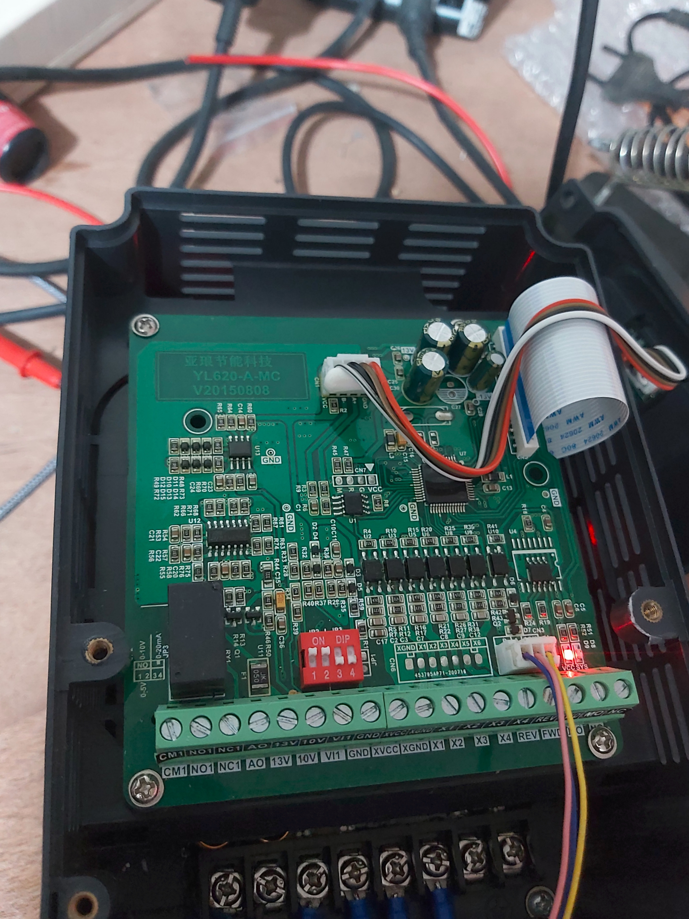

31 Aug 2021 20:00 - 31 Aug 2021 20:20 #219281 by rounyworks
Replied by rounyworks on topic yalang yl620 VFD rs485/modbus communicaiton
please help me i'm problem wih this vfd
Opening /dev/ttyUSB0 at 9600 bauds (N, 8, 1)
vfdmod: reading 'spindle.rpm-out' from address 8203 (0x200B)...
[01][03][20][0B][00][01][FE][08]
Waiting for a confirmation...
<01><83><03><01><31>
ERROR Illegal data value
vfdmod: setting command speed value to 500 (0x01F4)...
[01][06][20][01][01][F4][D3][DD]
<01><86><03><02><61>
Last edit: 31 Aug 2021 20:20 by rounyworks.
02 Sep 2021 00:25 #219381 by andypugh
Replied by andypugh on topic yalang yl620 VFD rs485/modbus communicaiton
Are you sure that 9600 / N / 8 / 1 is correct for the VFD?
03 Sep 2021 00:17 #219475 by rounyworks
Yes this my VFD setting
P00.01 = 3
P03.00 = 3
P03.01 = 1
P03.02 =  2
P07.08 =  5
