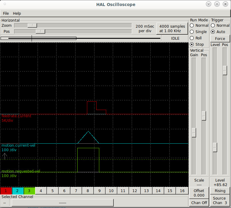

Replied by rodw on topic Is there a Halpin for the current feedrate
Thats very exciting you got that far.
motion.motion−type will let you know if it is a traverse (G0), Linear feed (G1) or an arc (G2,G3) so you should be able to filter it from here.
The problem with motion.requested-vel is that it reports the feedrate that the motion controller has set for a given segment which can be reduced if it is too short a segment to allow the trapezoidal acceleration profile get to the feedrate. These graphs hopefully demonstrate what I mean. The one on the right is constrained to 6000 mm/min instead of 10240 mm/min as on the left
If you use halscope to monitor motion.current-vel, you will get exactly this shape. It would be interesting to monitor your pin with motion.current-vel and motion.requested-vel in halsope on short profiles to confirm it is correct.
So now it would be great if somebody could give a clue about how to access the same data from a realtime component created with halcompile. Something I've wanted to do for a long time.

02 Jun 2020 17:33 #169834
Actually, rereading your last post, I did not address the feed override. You need to calculate the true feedrate yourself with some simple maths. You can do this in your screen handler. Its ages since I played with that stuff but cmorely is the expert. So hopefully he will help if you get stuck.
And of course in that handler you can set the value to zero when motion.motion-type = 0 (idle)

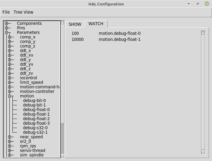

Replied by Aciera on topic Is there a Halpin for the current feedrate
Hm, I'm somewhat out of my depth here but I wonder if this wasn't to be expected considering we're using a python script instead of a precompiled component written in C.
- Posts: 12156
- Thank you received: 4149
03 Jun 2020 12:42 #169936
You are not the only one out of your depth! It says its available in shared memory so it should be visible from Python too.
I Wonder what comes back when you run this?

03 Jun 2020 14:08 #169941
Well, I've been digging through the code and came up with these variables in the state tags as being the ones we want.
When I am near my machine again, I Was going to try creating an external variable inside a component. But its midnight here...
I was hoping you might see a structure similar to the state tags, but it does not seem so. I'd say the python structure needs updating.
Well I made some progress pulling out state tags data using the debug pins This is using the default axis metric sim.
Note these are parameters, not pins, so open the correct section in halshow. The first entry is the feed rate, second entry is spindle speed
In /src/emc/motion..c around line 1937 make these changes (The first two lines need to be added, then the last two need to be modified
I think I know now how to add dedicated pins for the state tags now so I''ll keep playing with this.
struct state_tag_t *tag;
tag = &emcmotStatus->tag;
emcmot_hal_data->debug_float_0 = tag->fields_float[GM_FIELD_FLOAT_FEED];
emcmot_hal_data->debug_float_1 = tag->fields_float[GM_FIELD_FLOAT_SPEED];I think I know now how to add dedicated pins for the state tags now so I''ll keep playing with this.
