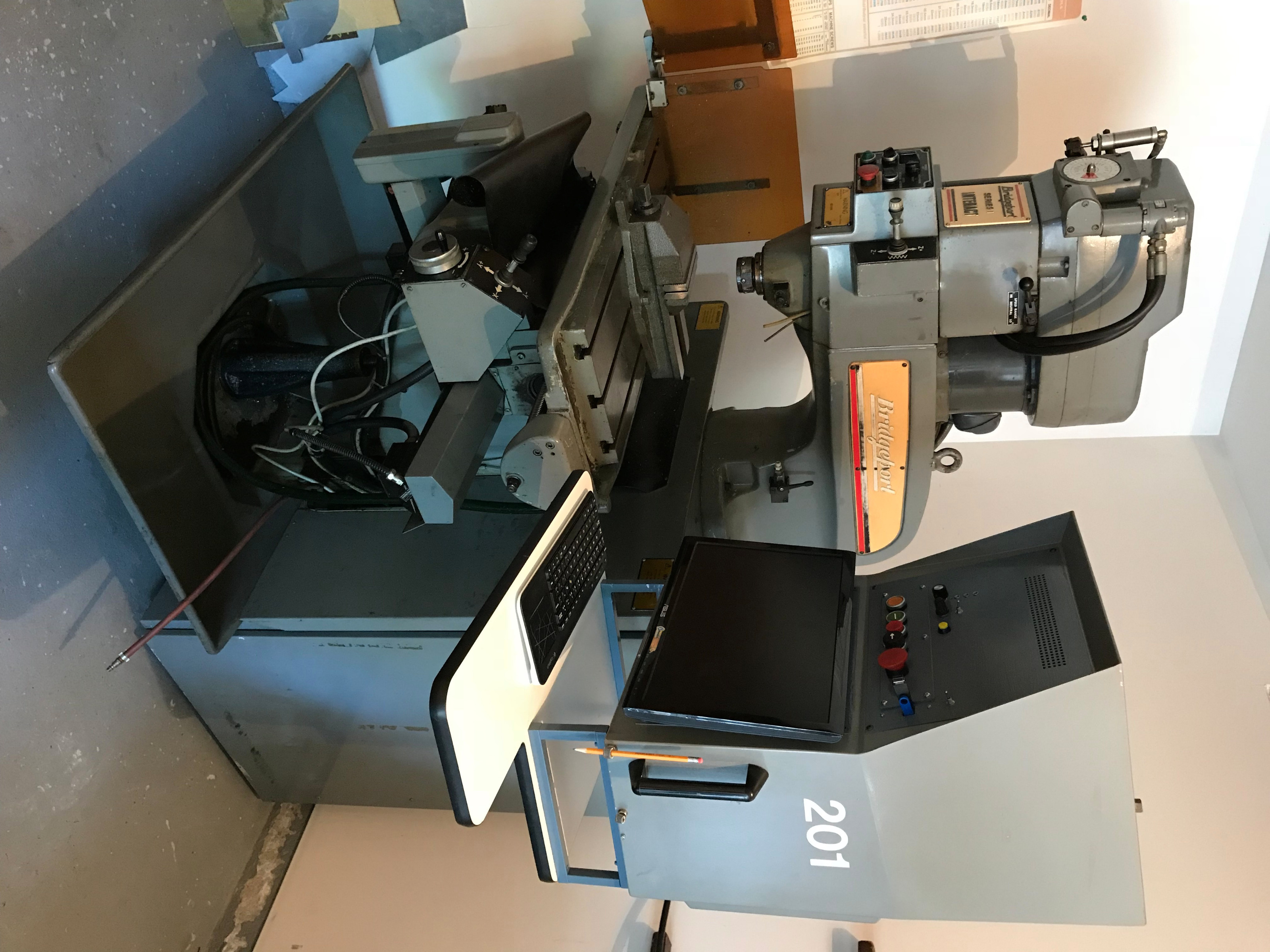

Hi! I need help in configuring my HAL file to adjust the feed override with a potentiometer. I upgraded a Bridgeport Interact 1 cnc mill. I have a 555 IC providing 5V "steps" to the encoder 04 pins of my Mesa 7i77 card. The signal looks good on my oscilloscope. The frequency from the 555 can be varied with the pot from 20Hz to 160Hz. I am using phase A only of encoder 04 connector (single ended). The ground wire is also connected. I tried using the MPG input 16 rather than the encoder 04, but it I didn't succeed. I also have a switch to enable feed override. When I turn on the switch, the cursor on the "axis" screen for feed override flickers back and forth quickly from 0 to 100 to 0. I change the scale for FO in my HAL for other values, but the cursor of FO will still moved quickly back and forth. My lines in my HAL file for feed override are:
