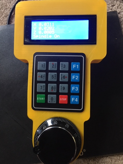

Does anyone have a good example of using multiswitch? I'm trying to use one button to toggle through a jog scale of 0, 0.001, 0.01, 0.1 and I can't find a good example.

I appreciate the information but I don't think it will work for my application. I'm using an arduino micro to build a joypad pendant as I outline in this post.
forum.linuxcnc.org/show-your-stuff/39435...joypad-and-hal-input
I've moved quite far along with this project but still a way to go. I've added a LCD screen (python script), rotary encoder and button inputs. Its amazing what you can do with the arduino joystick library.
I was hoping the multiswitch component would allow me to toggle through a jog scale with one button. Right now I have to hold a axis button, a scale button and turn the encoder.
Is the multiswitch component not used or is there a better way to toggle multiple items?

10 Jul 2020 07:24 #174190
by phillc54
Replied by phillc54 on topic Multiswitch
You could do something like:
loadrt multiswitch cfg=3
loadrt mux4
addf multiswitch.0 servo-thread
addf mux4.0 servo-thread
setp mux4.0.in0 0.001
setp mux4.0.in1 0.01
setp mux4.0.in2 0.1
net sel0 multiswitch.0.bit-01 => mux4.0.sel0
net sel1 multiswitch.0.bit-02 => mux4.0.sel1
net scale-button <your_button_pin> => multiswitch.0.up
net scale-out mux4.0.out => <your_scale_input_pin>Please Log in or Create an account to join the conversation.
- muntzieman
- Posts: 4
10 Jul 2020 14:56 #174215
by muntzieman
Replied by muntzieman on topic Multiswitch
This is the example I've been looking for. It worked perfectly, thank you.
