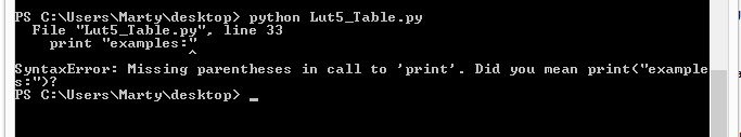

Hello.
I have been using Lut5 a little bit lately.
I have found the Wiki to be good, however there is a python script available for download which does the math for the "function" parameter (truth table) in hex to set the desired results.
The problem is that I get an error message. From that message I am strongly wondering whether it is a python version (syntax) problem (as I seem to recall a difference in the print syntax requirements between older/newer versions of python...???)
I have attached the error message for reference.
Thanks Marty.

Opening it with a text editor and adding missing parentheses should work.
The lut5_table.py file.

yes that looks like a python3 vrs python2 problem. python3 requires brackets on print statements. There is a utility program for python2 to python3 conversion.

Yep, got it, "2to3" did the trick (I used the online conversion tool).
