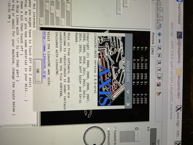

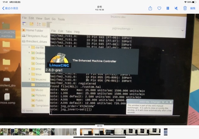

pi@raspberrypi:~/linuxcnc-dev $ uname -a
Linux raspberrypi 5.4.51-v7l+ #1333 SMP Mon Aug 10 16:51:40 BST 2020 armv7l GNU/Linux
LINUXCNC - 2.8.0~pre1
