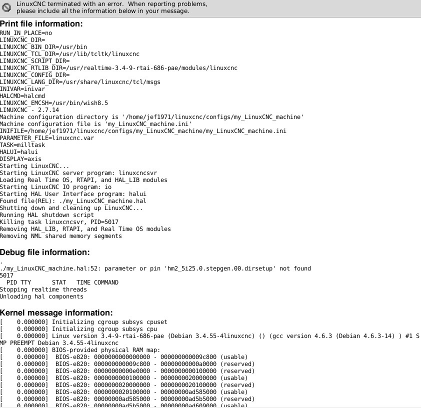

i did a setup whit pncconf for 3 axis ,but i got this error when i run.

Seems your card is not initialized, pins are only available at runtime after initializing card.
Is the card present in the slot? Is the right firmware flashed/provided that has a step generator ?

Replied by PCW on topic error 5i25
Looks like the 5I25 firmware is not correct for a 7I76
If you bought a 5I25+7I76 kit recently, some were sent out
with incorrect firmware for a 7I76
I would reflash the card with 7I76 firmware:
sudo mesaflash --device 5i25 --write 5i25_7i76x2.bit
5i25_7i76x2.bit is in this zip file:

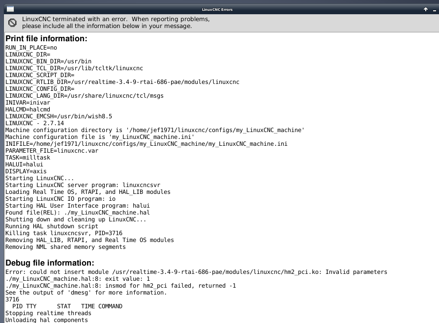

28 Sep 2020 00:15 #184082
by jefsaro
Replied by jefsaro on topic error 5i25
I updated the firmware, it is always the same

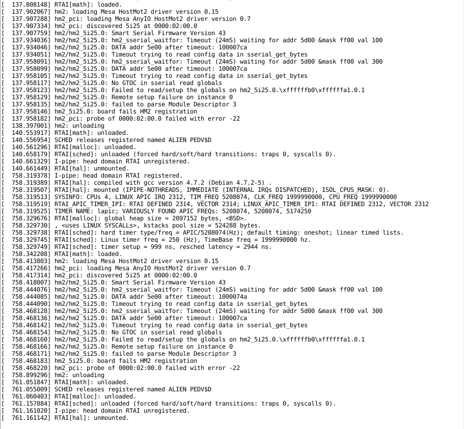

28 Sep 2020 00:56 #184086
Did you reload the FPGA with the --reload command or power cycle the CPU?

28 Sep 2020 05:55 #184109
by jefsaro
hello ,
after verify , i 'make a mystake whit pins w1 is off, now i put on , all is ok , thanks for your help
