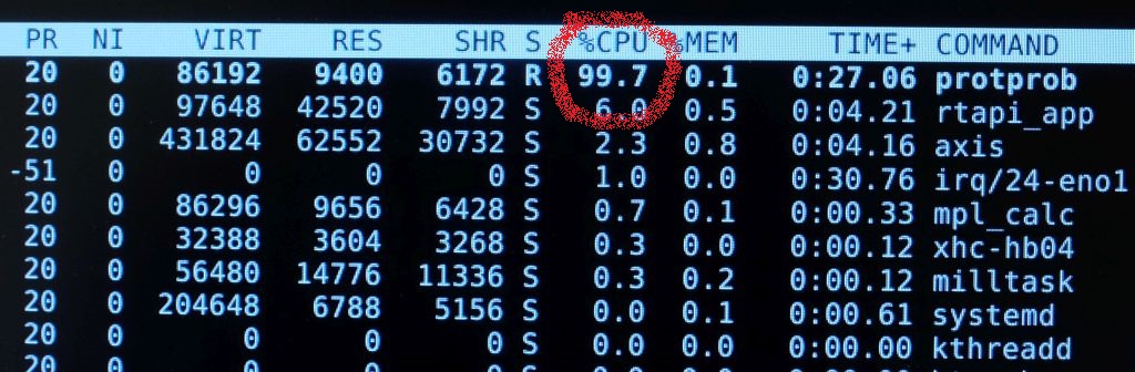

Until the problem with not recognizing probe deflection while moving without G38.n is solved, i continue use this.
When i checked the load of the PC with 'top' , i was wondering about the high cpu load reached from this component.
When the probe is not loaded, the sleep timer of about 5 seconds is no problem, but time.sleep(0) when probe in spindle, is not a good idea. So i tested some other values.

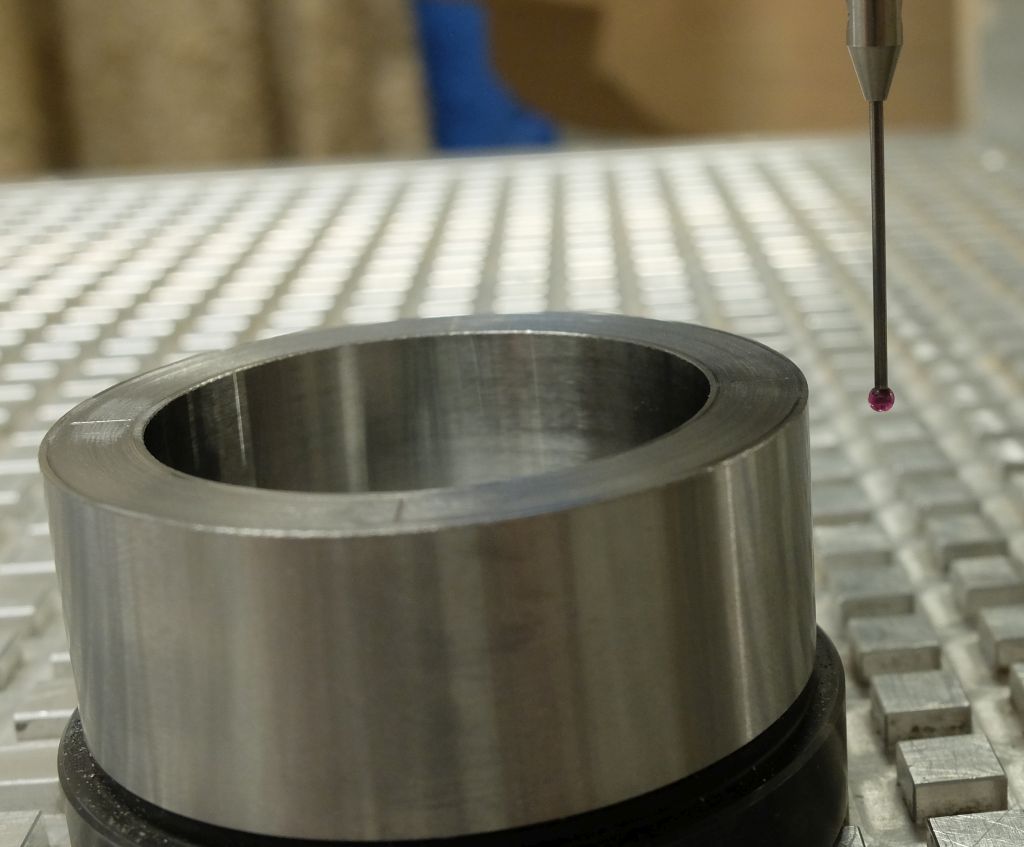

I set the probe contact point on my calibration ring to X zero, and in the ngc file a movement G1 X-0.5 F500. In worst case, this 0.5mm won't hurt the probe.
In my probing routines feed is set to F100 for probing, travelling around F500. That's why i tested only this.
time.sleep(0.001) F500 stoped finally between X-0.262 and X-0.3
time.sleep(0.0005) F500 stoped between X-0.35 and X-0.358
time.sleep(0.00001) F500 stoped always at X-0.35.
Always a cpu load from 0.3% to 2% reached.
time.sleep(0) only produced a very high cpu load, and stop was also at X-0.35
So I will use time.sleep(0.001), which produces average 0.3 %
I can live with stoping within 0.35mm, as the possible deflection of my probe is larger.
