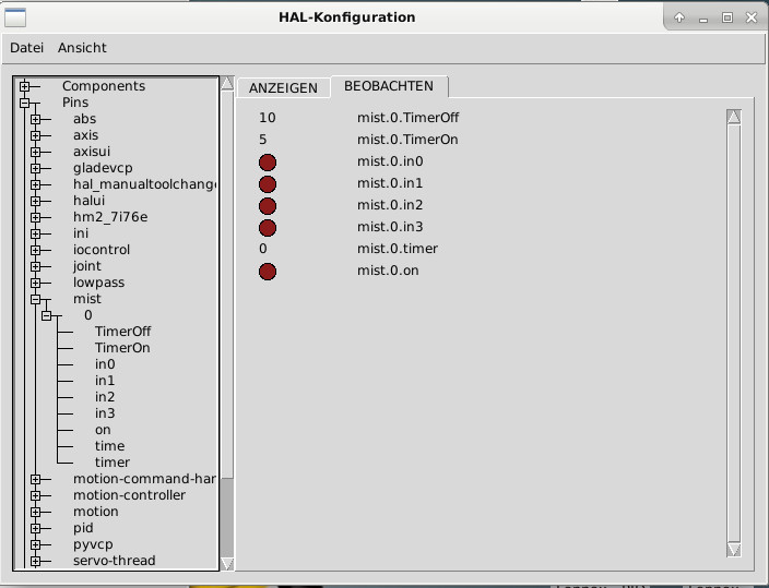

Hi Bob,
I wrote short modul for this.
Its pretty easy to use.
Timer Could adjust by setp timeron and off
If you have compile , install and load Take a Look in halshow.
You will found new Modul with pin In, pin out And timer
forum.linuxcnc.org/10-advanced-configura...w-hal-modul?start=10
Hope it helps Christian

hello Christian,
thank you for your quick response.
Because I'm new to linux and am not a programmer, I don't understand were to put in the code. Does it all go in den *.hal file or do I create a new *.comp file?
I couldn't install the mist.comp file.

Hi Bob,
file mist.comp is the code file. In file header you can see how to compile and install it. If you want to use finish work rename the file mist.so.comp in mist.so and install to folder /usr/lib/linuxcnc/modules/.
Now you can use this module in hal file. Howto use in hal is also decriped in header. Basicaly you have 4 input and one output. short writen
if mist.0.in0 -> mist.0.on
else if mist.0.in1 && mist.0.in2 -> mist.0.on
else if mist.0.in2 && mist.0.in3 -> mist.0.on for mist.0.TimerOn and off for mist.0.TimerOff

hello Christian,
thanks again. I copied your file in the diretory and found the function in the hal configuration.
Next I will try to figure out, how to connect it to the mist-coolant.
I I'll give it another try on the weekend.

So I gave it another try this sunday, figuring out how to make the connections work.
Still trying to understand this HAL file.
# ---Interval---
net mist.is-on mist.0.in2 halui.mist.is-on
net mist.is-on mist.0.in3 halui.mist.is-on
net collant-mist mist.0.on hm2_7i76e.0.7i76.0.0.output-00
Works really good.
