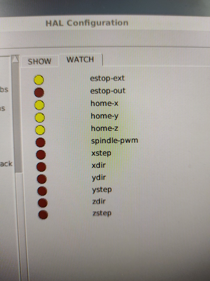

22 Jan 2021 10:29 #196193
Replied by rodw on topic Limit Switches, EStop and Spindle
So if you are seeing a voltage drop, you should be able to run halshow (or Show machine Configuration in Axis),
Click on the watch tab and find the pin you are connected to. Trigger the sensor and you should see a pin trigger on and off by changing colour.
In my experience, people jump ahead a few steps instead of taking a slow methodical approach. A few more minutes here will save much gnashing of teeth!
Steps should be:
1. Confirm sensor behaviour is working with a multimeter ( you seem to have done that)
2. Confirm the sensor is triggering the pin you have connected it to using halshow (what I have asked)
3. Connect the sensor in Hal to where you want it connected.
4. Confirm that pin triggers with the sensor
5. Fix any errors in your thinking by editing your hal files.
Please remember that Linuxcnc has its own paradigm which defines expected use.
Rule #1 of any computer system. DO NOT FIGHT THE PARADIGM!

22 Jan 2021 11:13 #196200
by Marsbar
Replied by Marsbar on topic Limit Switches, EStop and Spindle
Hi rodw,
Thanks for your reply (and indeed to all who have responded so far. it is much appreciated:)
I have tried this before, but done it again just now.
There is NO response from the ESTOP pin.
The limits switches are the same with no response.
The xyz axis are all responding.
Even the Spindle (out signal) is giving a response here, but nothing at the BOB
Does the HAL SHOW facility give the actual response/voltage/signal at the Parallel Port
or are we still in the 'virtual world' of programming - if that makes sense???
In other words would this indicate that there might be problem with my PCI card?
(I have checked the integrity of my parallel cable and it is fine.)

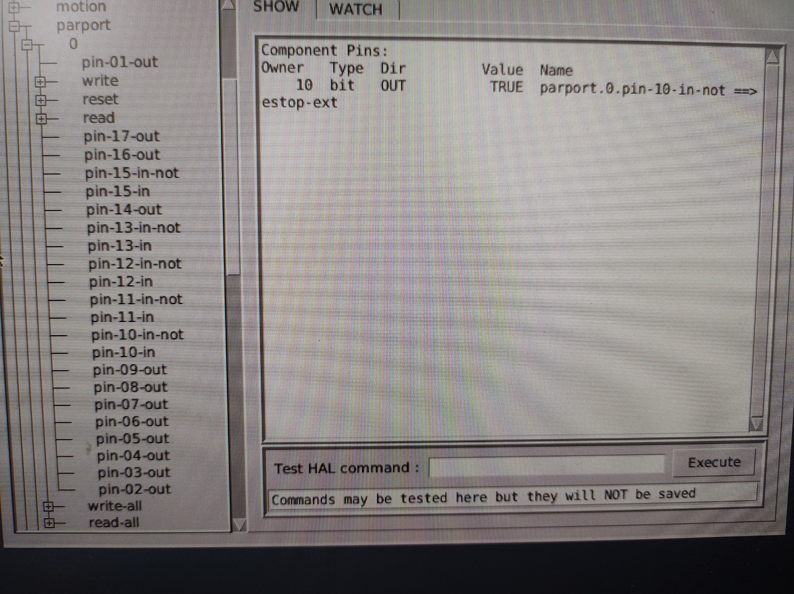

22 Jan 2021 11:49 #196203
by Marsbar
There doesn't seem to be an option for 'input' here!
The path I have got (below) is pins>parport>0 and the list of pins
Notably perhaps the Dir is listed as 'OUT'!
(and all the pins listed here say the same - Dir - OUT)
They also say under OWNER: '10'
Does this mean somehow they have got linked to pin 10 by mistake
or am I barking up the wrong tree?

22 Jan 2021 12:42 #196208
Replied by tommylight on topic Limit Switches, EStop and Spindle
check the
pin-10-in
and
pin-10-in-not
on watch tab while toggling the switch
pin-10-in
and
pin-10-in-not
