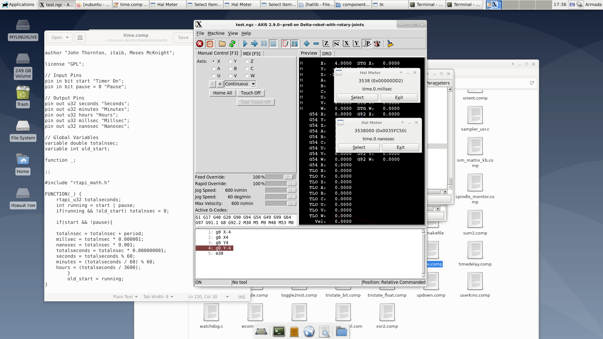

Good day.
Сan you tell me if there is a hal component timer.
I need it to count the time by "hal.program-is-run".
Started counting when hal.program-is-run is true and finished with false.
And returned the time of cycle.
If such a component or I need to do it yourself

Replied by rodw on topic Timer HAL Component

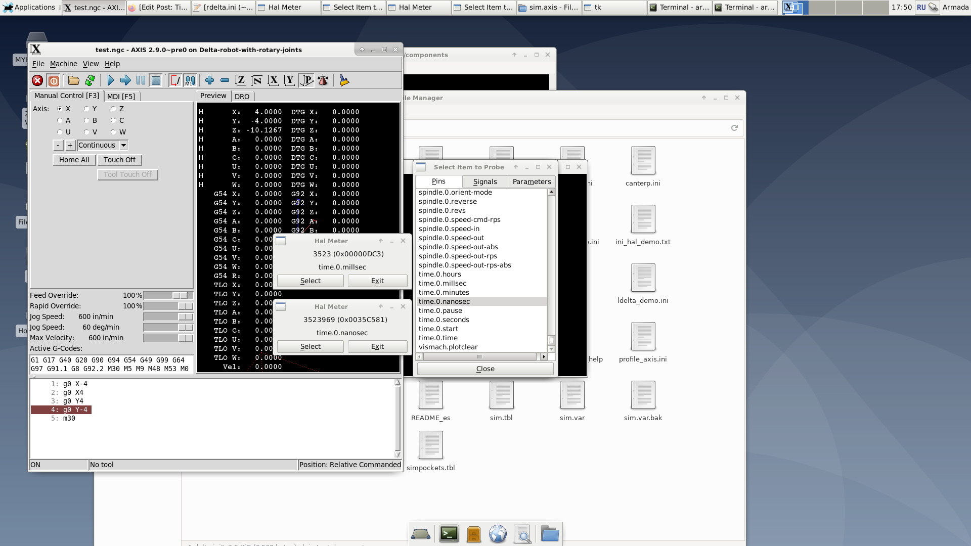

Thank you very much. This is what I need!
I still have to modify. But it seems easy)
Can I count nano seconds?
UPD I forgot to fix ini. Nano seconds count too

One more question: How I can predict this time?
If I know final control program.
