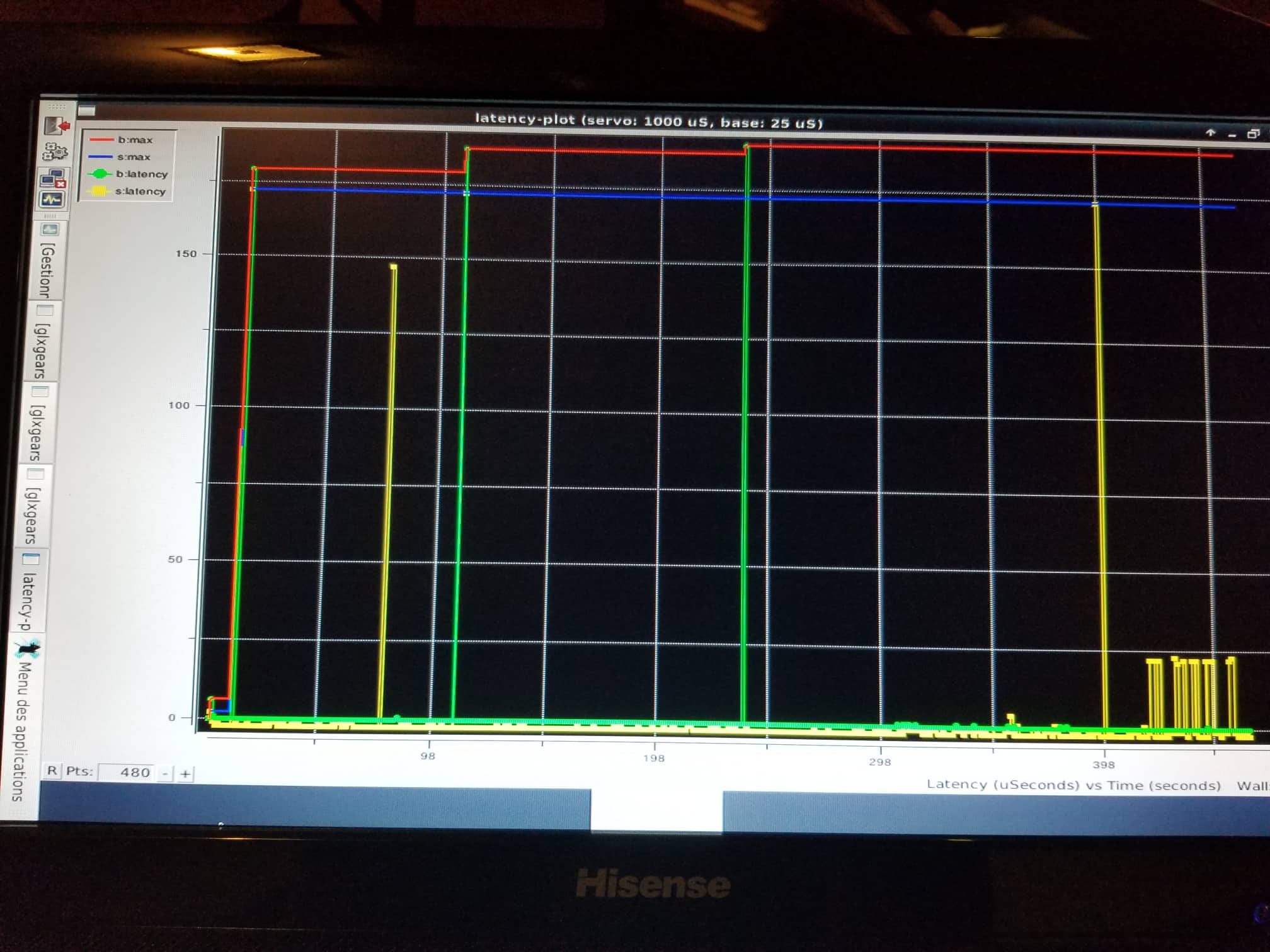

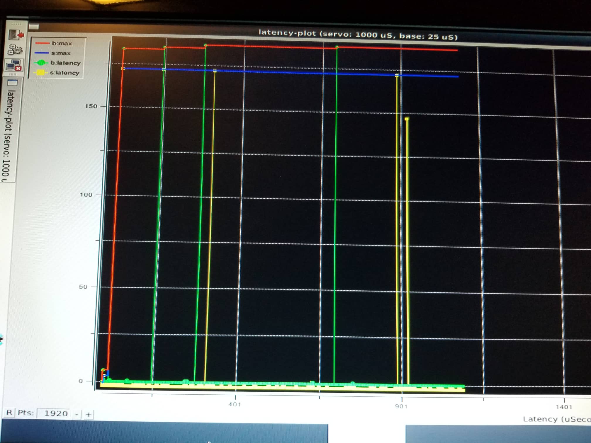

I'm building a linux based cnc with dc motors and encoders for the motion. So it's a closed-loop system. While I'm running the latency test, everything is fine except that sometimes, there are unexpected latency peaks à more than 150 (see pictures). I'm using the parallel port for controlling the cnc, no mesa card. Do you have any suggestions to troubleshoot this problem? Every comment is welcome.

Replied by tommylight on topic Latency peaks problem
Disable everything in BIOS regarding power saving, C states, ports/modem/audio, etc.
