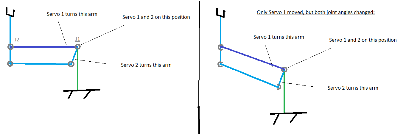

Hello, i´m new to this board so please excuse me if i do something wrong.
Currently i am retrofitting a Motorman K10S 6 - Axis robot. The original controlhardware is gone, i use the original servopacks and servos together with a mesa 7i77 card.
I can control each servo without any problem, encoder feedback works, too. (Using Axis)
Joint0 (S), Joint3 (R), Joint4 ( B ), Joint5 (T) are working, no problem.
But:
Joint1 (L) and Joint2(U) behave different.
I can drive servo Nr.2 (for Joint2) and the arm rotates as expected.
If I want to rotate Joint1 and drive servo Nr.1, Joint1 rotates as expected, but also Joint2, without any movement of servo Nr.2.
This is because of the geometry of the robot (Picture).
When i want to rotate Joint1 only i have to drive servo Nr.1 and 2 simultaneously.
Joint0 -> servo 0
Joint1 -> servo 1 + servo 2
Joint2 -> servo 2
Joint3 -> servo 3
Joint4 -> servo 4
Joint5 -> servo 5
I want to use genserkins to control everything in XYZ and as far as i know for the DH - Parameters each joint has to be directly coupled to one single joint.
How can i do this? Is this even possible in HAL? I tried gantry but i cant connect multiple signals to the analog-output-pin for the servo in HAL.
Thanks in advance

23 Feb 2021 15:13 #199838
Replied by Aciera on topic One Joint multiple Servos possible? 6-Axis Robot Motoman K10s
That's a tricky one.
"genserkins" uses a modified convention DH-Parameter model as discussed in
"Introduction to Robotics" by John J. Craig. The book can be found online.
In the book (Pages 83 to 89 ) the author shows an example of how to derive the required DH-Parameters for a Yasukawa Motoman L-3 that also has a parallelogram mechanism. Although only a 5-DOF robot you might be able to figure out how to derive the parameters for your robot.
So it seems to be possible to use linuxcnc and genserkins with your type of robot but you will certainly need to invest some serious effort.

23 Feb 2021 19:21 #199880
by xcp92
Replied by xcp92 on topic One Joint multiple Servos possible? 6-Axis Robot Motoman K10s
Thanks for the fast answer.
If Joint1 rotates, the 1 arm rotates around Joint1, but the arm connected to Joint2 stays in the same orientation to ground.
The ratio of both servos is 1:1.
I had calculated the DH - Parameters, but didn´t realised the parallel mechanism. I found the book Aciera mentioned, but i have no idea how to do the calculation for my robot. It seams totally strange ?!.
Its not possible to connect a single output to multiple signals.
Is there a way to do some math in the .hal file?
Or maybe a funktion that can do that?

24 Feb 2021 07:42 #199932
Axis coupling is mostly used in palletizing (I think). Here is good explanation:
robodk.com/blog/robot-axis-coupling/

01 Dec 2021 19:48 - 01 Dec 2021 19:53 #228148
by xcp92
Here is the working fix:
Custom component that redirects the signals so that only one joint moves:
These are the relevant parts from the hal file:
This works flawlessly so far. Hope this helps.
component motomanfix "Fix for Motoman K10S";
pin in float j2_fb_in;
pin in float j1_pos_cmd_in;
pin in float j2_pos_cmd_in;
pin out float j2_cmd_topid_out;
pin out float j2_fb_tojoint_out;
variable float j1_pos_cmd_base = 0;
function _ fp;
author "Xcp92";
license "GPL";
FUNCTION(_)
if(j1_pos_cmd_base == 0) j1_pos_cmd_base = j1_pos_cmd_in;
j2_cmd_topid_out = j2_pos_cmd_in + (j1_pos_cmd_in - j1_pos_cmd_base);
j2_fb_tojoint_out = j2_fb_in - (j1_pos_cmd_in - j1_pos_cmd_base);
}These are the relevant parts from the hal file:
loadrt motomanfix
addf motomanfix.0 servo-thread
net j1-pos-cmd <= joint.1.motor-pos-cmd
net j1-pos-cmd => pid.j1.command
net j1-pos-cmd => motomanfix.0.j1-pos-cmd-in
net j2-pos-cmd <= joint.2.motor-pos-cmd
net j2-pos-cmd => motomanfix.0.j2-pos-cmd-in
net j2-cmd-topid <= motomanfix.0.j2-cmd-topid-out
net j2-cmd-topid => pid.j2.command
net j2-pos-fb <= hm2_5i25.0.encoder.02.position
net j2-pos-fb => motomanfix.0.j2-fb-in
net j2-pos-fb => pid.j2.feedback
net j2-pos-fb-tojoint <= motomanfix.0.j2-fb-tojoint-out
net j2-pos-fb-tojoint => joint.2.motor-pos-fb
