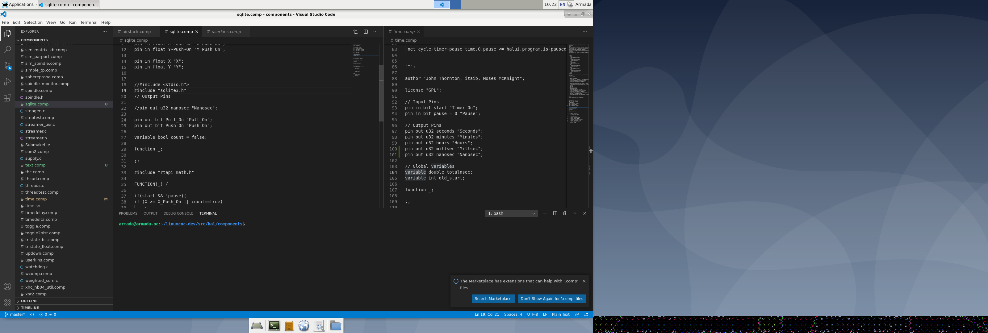

Hi everyone
Can someone tell you step by step how to import a library to create a new hal component. Or if it's not difficult to write a guide for dummies. What to put in what folders and etc.
The example requires using the SQLite library. or simpler Stdio
Last edit: 24 Feb 2021 07:24 by TheRoslyak.

by TheRoslyak
Replied by TheRoslyak on topic Include New Library For own Hal-Componet
I didn't mean it.
I meant how can I import my library (for example SQLite)
Now If now I just write #include <sqlite.h> - then I get an error.
I just don't know how to put it in the right folders. sqlite.h & sqlite.c in derectory Linuxcnc-dev.
I will explain what I want to implement:
The data that is written to the database appears after the camera is detected object.
Objects appear as the conveyor moves. I want to calculate where this object will be located after some time.
To do this, I attach an encoder and find the real position of the object

28 Feb 2021 22:13 #200469
To include a library in a .comp you need to use the "include" command above the ;;
"include" is a halcompile directive which puts the "#include" in the right place in the generated C file.
linuxcnc.org/docs/2.8/html/hal/comp.html#_syntax
Replied by andypugh on topic Include New Library For own Hal-Componet
I didn't mean it.
