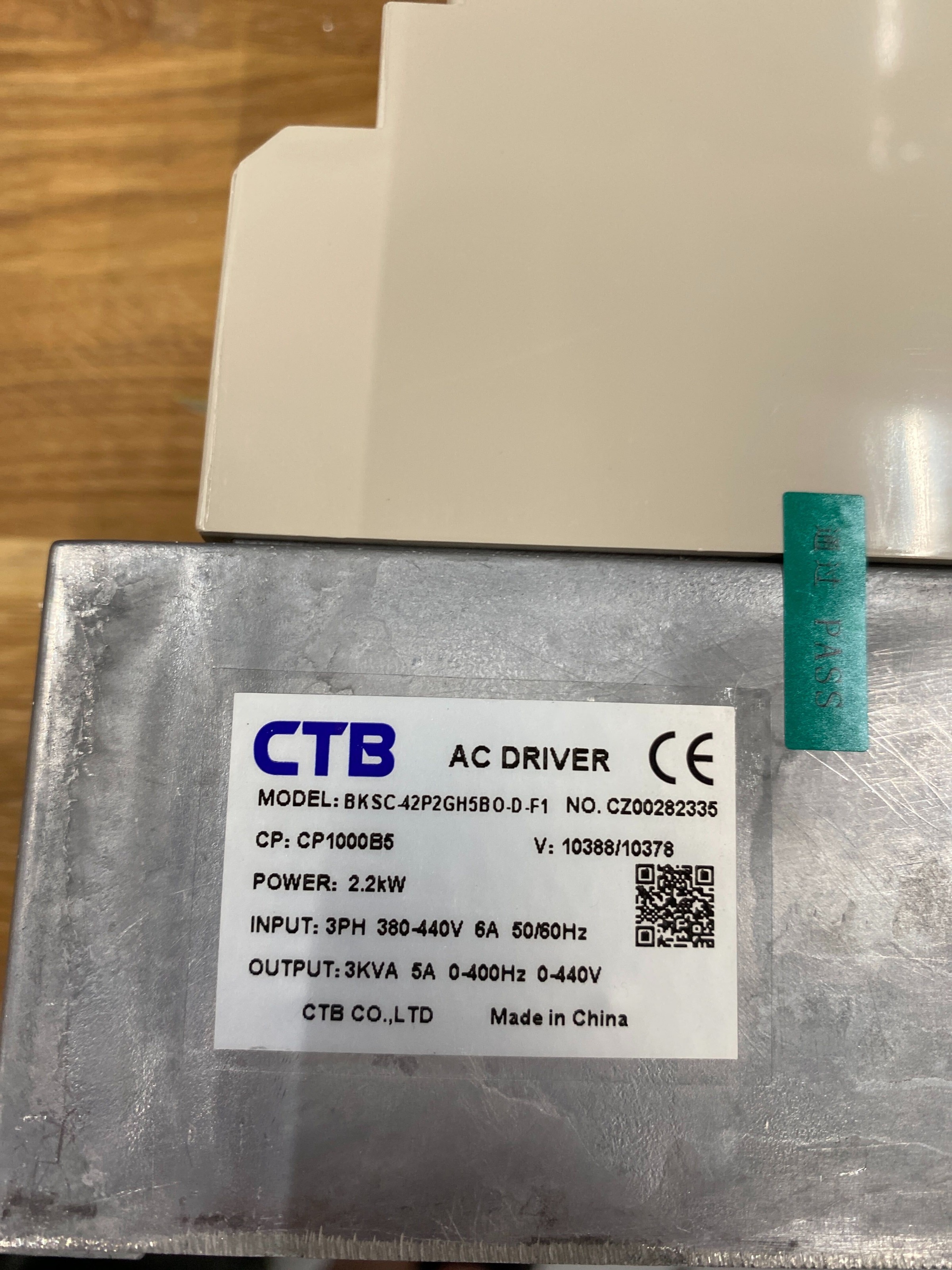

Yeah, sure thing! I've attached the configuration, but be aware that is just for testing and gobbled together from different sources...
I've also attached a picture of the driver and the ethercat manual that comes with the drive...
Any pointers are really appreciated!

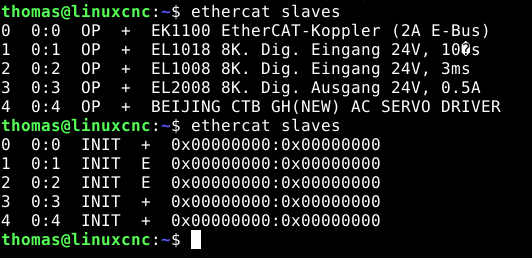

And you are totally right, it works! THANKS! However, it only works for a brief moment:-/ I hear something clicks in the driver and i can feel the servo is powered on(it resists me trying to rotate it)...but only for a couple of seconds, then it turns of again...no errors, no warnings, no nothing....strange... something foobar is going on, look at what ethercat-cmd is telling me just before and just after "EnableOperation=1":
...is this supposed to happen? It seems like everything is broken afterwards....actualPositions stops working etc...
I tried multiple times, also only with the driver...also after a restart of everything, the result is the same every time....
/Thomas

10 Mar 2021 15:47 - 10 Mar 2021 15:53 #201654
by thomaseg
Thanks! You were absolutely correct!
I moved the driver/servo futher way(2m instead of 20cm) and added a grounding wire between servodrive and the EK1100 and now the driver stays on...so definitely a EMF problem...In the real setup i will house the drivers in their own chassis to help with noise and have everything grounded properly...
Thanks a million! Your help has really made my day
/Thomas
