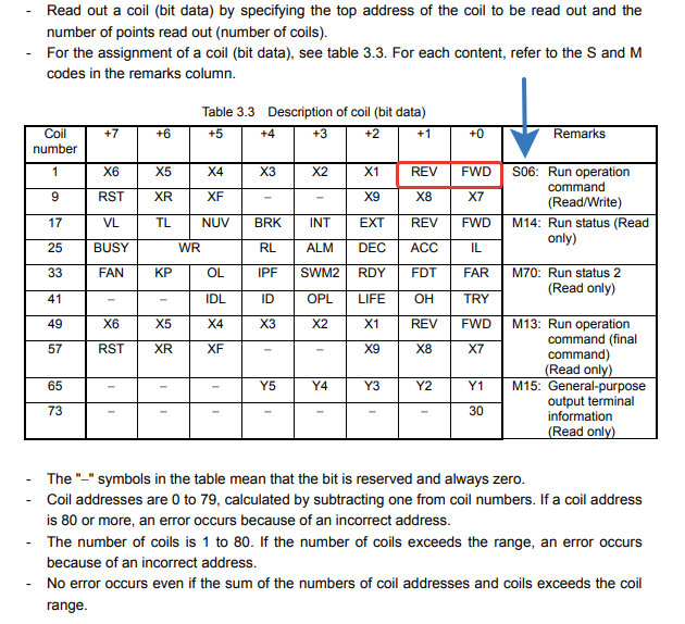

Ok, take a look on page 3-7, table 3.3 of "Jaguar RS485 Man.pdf", to run your VFD forward or reverse you have to preset coils number 0 (FWD) or 1 (REV). I guess to stop VFD both coils should be reseted to 0, but it's not important now. According to remark in that table command operations also supported by S06 command, and this is important

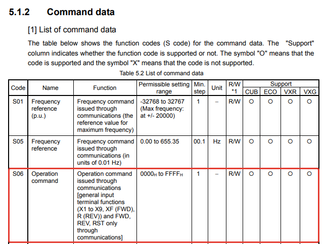

Page 5-2, table 5.2 describes S06 command, it provides access to 16-bit control word, where bit 0 is similar coil number 0, and bit 1 is similar to coil number 1.

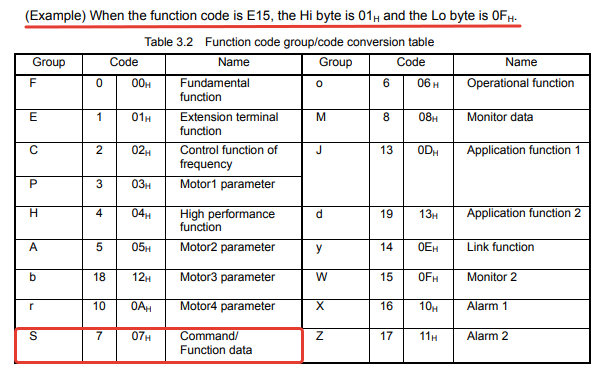

To convert S06 command code to register's address see page 3-4, table 3.2, the address should be hi(0x07) & lo(0x06) = 0x0706.
So, according data above, your control word address is 0x0706, and the control values are:
0x0000 - stop (bit 0 and bit 1 are cleared)
0x0001 - run forward (bit 0 is set)
0x0002 - run reverse (bit 1 is set)
To send a command word to VFD you can use MODBUS function 0x06 (write single register) or 0x10 (write multiple registers).
