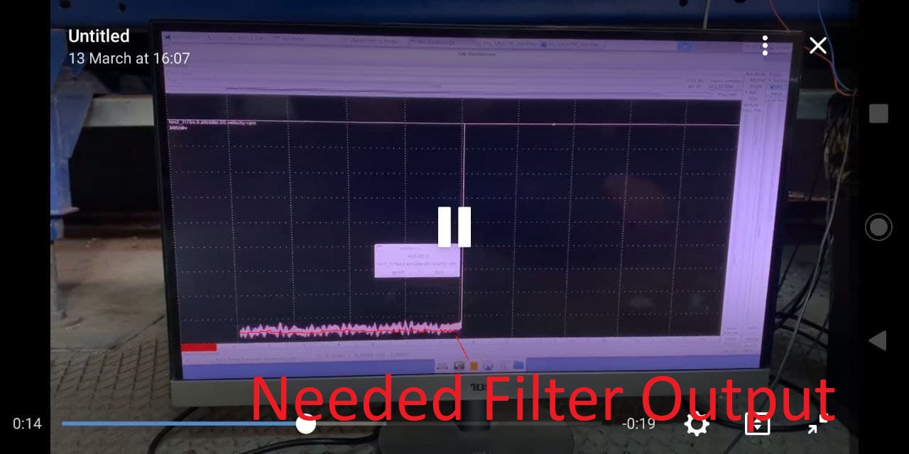

Can you explane:How to configure Filter Kalman?
Now I have input and output is same. (With default parametres)

I meant how to correctly configure "filter-kalman.N.Rk" and "filter-kalman.N.Qk"

As a practical application, I tried using this to filter noisy analog inputs for my overrides (JRO/FRO/SRO).
Using a Mesa 7i73 and 0-20k pots, I was getting enough input voltage flicker that it was affecting the commanded speed by +/- 0.2 ipm during what was intended as a continuous jog.
Experimentally, the following settings stabilized the output to halui.jog-speed enough so there is zero 'flicker' anywhere in the pot's range:
kalman-filter.N.Rk = 0.000001 (1e-6)
kalman-filter.N.Qk = 0.000001 (1e-6)
I'm sure someone who understand any of the filter math would be able to set this more appropriately, but the above values might be a useful starting point for anyone trying to tame fluttering inputs.
