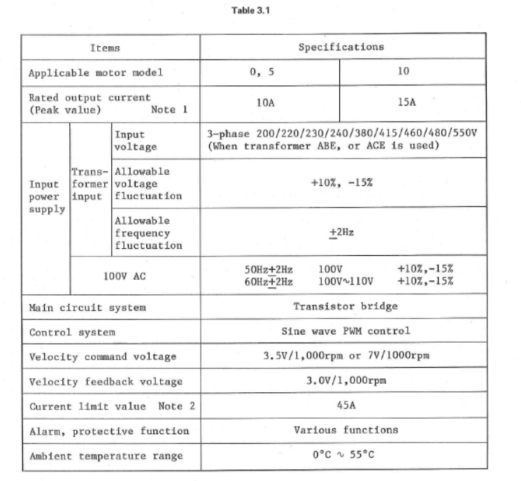

It is a Fanuc AC servo motor Model 5 (A06B-0512-
The driver is model A20B-1001-0770. Specs are attached.
The machine is a Cincinnati Milacron Sabre 500.
Is there a way to tell if it is a VFD or not? From the documentation I have, it says "VFD"

Well, I suppose that all AC servo drives are also Variable Frequency Drives, because they are drives and work at variable frequency.
But VFD has come to be used mainly for drives where the primary control is via frequency, whereas most AC servo drives control the current and the frequency is set by the motor speed via the commutation feedback.
Anyway, with that clarified.
In the HAL there is likely to be a PID for each axis, the output of which goes to the Motenc DAC. That PID output pin will offer an approximate measure of motor load.
