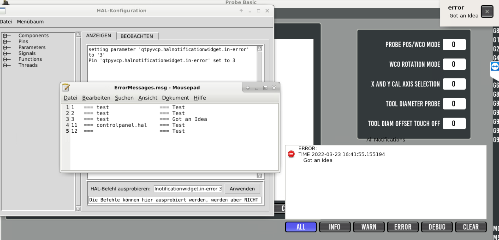

21 Mar 2022 12:02 #237904
by Thom
Replied by Thom on topic Python Component issueing errors or warnings to LinuxCNC
Its a realy good idea!
I wanted to do the same on my machine:
So you have modified your "emcmodule.cc" file
Where can i find this file?
(searched my computer with $sudo find / -type f -name *emcmodule.cc" but there was no result..
Best regards,
Thomas
Best regards,
Thomas

23 Mar 2022 15:46 #238109
by Thom
Thanks for the information, but i am still not able to find any .cc file on one of my machines.
Maybe it's may fault: im not an expert yet
But i have no idea, where to start..
Meanwhile i extended the existing "QtPyVCP NotificationWidget" with a s32 HAL input Pin: ( error-number)
By changing the pin value, it gets the User defined message from a file in the config folder (in the file, you can assign your s32-numbers to user defined string messages)
The extended hal Widget does the following:
=> on the Plugin "notifications" : notification_channel.captureMessage is called with the assigned message
=> self.on_error_message is called with the assigned message
Hope, i can help someone else with this content (It took me almost 20 hours to get a basic idea, how to do it
Best regards,
Thomas
