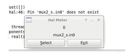

Hallo,
I would like to jog via joypad and / or via the pyvcp keys.
I have two values, "pyvcp.jog-speed-f" coming from the panel and "joy_mux4.out" coming from the joypad.
The intention was to select the correct speed via a "mux2".
I came up with this construction;
net keuze_joy <= joy_mux4.out => mux2_s.in0
net keuze_toets <= pyvcp.jog-speed-f => mux2_s.in1
A message that "mux2_s.in0" does not exist
But as you can see in the screenshot, the "halmeter" does show this pin.
So,
With a "#" in front of the lines start axis, and the barometer indicates the pin.
Without the "#" I get the error.
Anyone have any idea what's going on?

01 May 2021 21:19 #207573
Replied by andypugh on topic jog speed via joypad and pyvcp-keys
Sorry for the late reply. What was the problem?
My first guess would be that you were trying to use the mux2 in the HAL file before it was loaded?
- guido-52
- Posts: 25
02 May 2021 05:58 #207600
by guido-52
Replied by guido-52 on topic jog speed via joypad and pyvcp-keys
thanks for the follow-up, indeed a beginner's mistake .....
