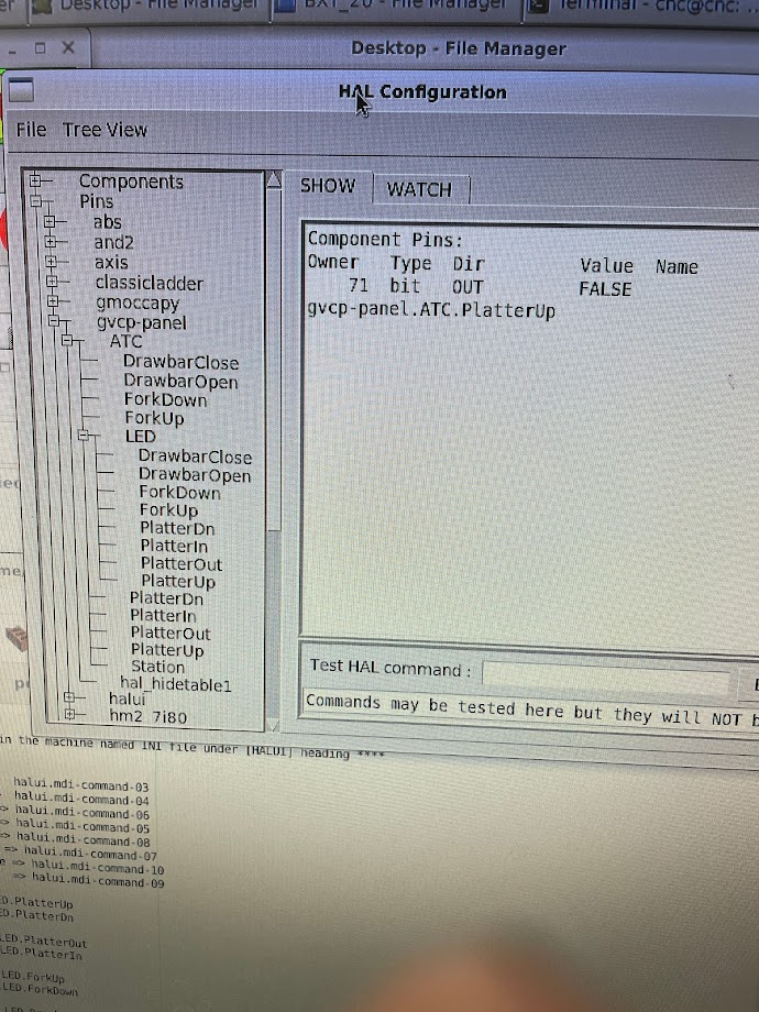

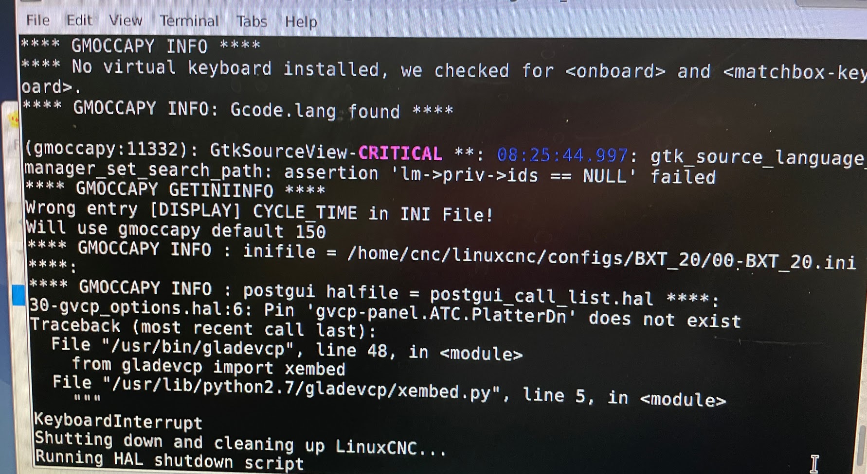

Hi all,
I'm having an issue that just popped up my CNC I'm retrofitting. It's been working really well for about a month and all of a sudden I'm having an issue. I get a pin not found on my ATC Control panel that uses Glade-vcp in XML. If I comment out the HAL file that maps the LEDs and Button LinuxCNC starts right up.
I have the .HAL for the buttons in Post_Gui. Also weird if I delete the preferences file for Gmoccappy, LinuxCNC will launch 1 time and work perfectly. On the next launch, it fails to start.
Here are the files and errors.
LinuxCNC 2.8.2
Also, if you see something that seems wrong please let me know. Thanks!

I would suggest you use gladevcp's -u path-to-hal-file switch.
Then have the gladevcp's HAL file only connect signals to the widget pins.
Then it doesn't matter the order.

You need to do all Hal connections for gladevcp panels with an own Hal file. Within the command in the INI file you have to specify that Hal file, IMHO it was the -H flag to specify.
Out of menory.
Norbert
