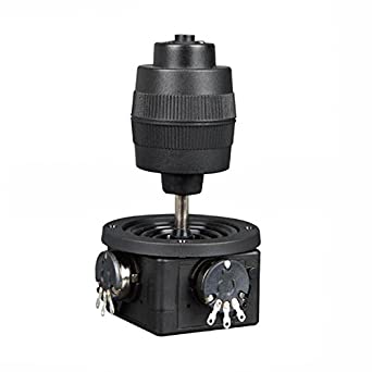

Hello im not that much into Hal Programming, so i really would be happy if someone can guide/help me to get my analog joystick to move my 3 axis, while holding down a safety button.

I think the analog jog is setup more for the joypad controllers as it is looking for a value of -1 to +1
Just looking at your joystick picture it appears each direction of the stick is a potentiometer. Assuming you are going to have it powered by 24v then the output range would be 0-24v and that will need to be scaled down to 0-1 using the scale component. On the X+ side just use a scale gain that brings the range down appropriately. On the Y- side use the scale gain as a negative value to scale and convert to the 0 to -1 range.
Both of those scale outputs would be feed into the halui jog pin and could use a mux2 component of you wanted to make it super tidy.
There is probably a better way to do it but this is just a thought.
The following user(s) said Thank You: Kasper-001

maybe it´s me that don't understand it
the joystick has one potmeter for right and left, one for up and down, and the last one for twisting
example for readout on pot meter:
neutral value is 12vdc
left 0vdc
right 24vdc
so why is the use of 2 analog inputs ?
