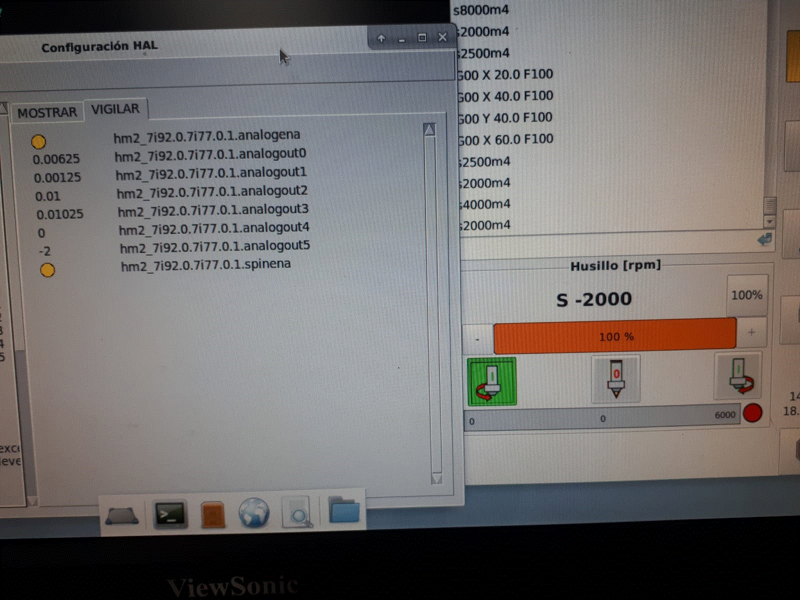

hello Clive S the only files that contain data are:
sabre_1000.ini
sabre_1000.hal
sabre_1000.ini.bak
position.txt
linuxcnc.var
The machine is:
Cincinatti sabre 1000 4 axis
thank you very much for the great help

Clive s
attachment in another missing file with data
sabre_1000.ini.bak
[EMC]
# The version string for this INI file.
VERSION = 1.1
MACHINE = CINCINNATI
DEBUG = 0
[HOSTMOT2]
# **** This is for info only ****
# DRIVER0 = hm2_eth
# BOARD0 = 7i92
# BOARD1 = 7i77
[DISPLAY]
DISPLAY = gmoccapy
POSITION_OFFSET = RELATIVE
POSITION_FEEDBACK = ACTUAL

[SPINDLE_9]
# Spindle
P = 1
I = 0
D = 0
FF0 = 1
FF1 = 0
FF2 = 0
BIAS = 0
DEADBAND = 0
MAX_OUTPUT = 8000
ENCODER_SCALE = 1000.0
OUTPUT_SCALE = 10
OUTPUT_MIN_LIMIT = 0
OUTPUT_MAX_LIMIT = 8000

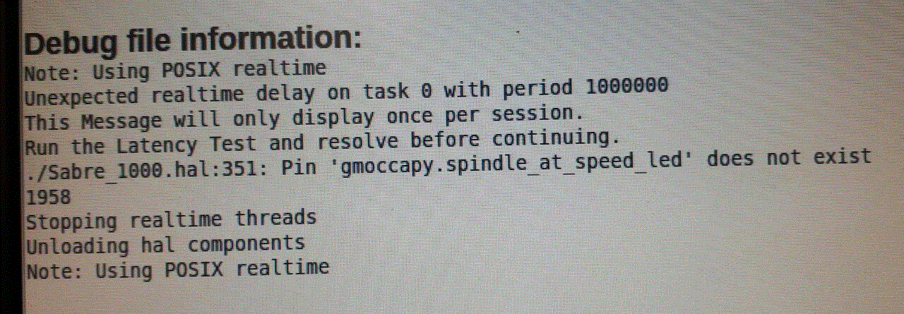

- Clive S
- Posts: 2204
- Thank you received: 486
24 Dec 2021 18:04 #229909
by Clive S
Replied by Clive S on topic I can't get spindle speed feedback
Ok
I see from the ini file that you are using DISPLAY = gmoccapy ie a different gui to what I use.
So I am sorry I cannot help.
Just for your info the config files that have a .bak ext. do not get used so the ini file that is in use is sabre_1000.ini
I believe that Chris cmorley is the go to guy for this.

24 Dec 2021 18:26 - 24 Dec 2021 18:29 #229914
by Michael
Replied by Michael on topic I can't get spindle speed feedback
This may need to be added to your custom_postgui.hal file since some of the pins may not be there till after the GUI loads.
You need to connect the spindle speed to the GUI pin. You already have this:
net spindle-vel-cmd-rpm-abs <= spindle.0.speed-out-abs
and need to add this
net spindle-vel-cmd-rpm-abs => gmoccapy.spindle_feedback_bar
To get the spindle at speed light to work correctly you will need to connect the spindle at speed signal correctly. Currently it is set to always assume the spindle is at speed. You will need to confirm these are the correct pins for your system, don't copy and paste.
#sets spindle-at-speed true
loadrt near count=1
addf near.0 servo-thread
net spindle-vel-cmd-rpm => near.0.in1
net spindle-fb-rpm-abs-filtered => near.0.in2
net spindle-at-speed <= near.0.out
net spindle-at-speed => gmoccapy.spindle_at_speed_led
setp near.0.scale 1.01
loadrt near count=1

- Servimet
- Posts: 24
24 Dec 2021 19:52 - 24 Dec 2021 19:54 #229919
by Servimet
Replied by Servimet on topic I can't get spindle speed feedback
Last edit: 24 Dec 2021 19:54 by Servimet.
- Servimet
- Posts: 24
24 Dec 2021 20:12 - 24 Dec 2021 20:16 #229920
by Servimet
maybe this information on halshow can help.
Last edit: 24 Dec 2021 20:16 by Servimet.
- Clive S
- Posts: 2204
24 Dec 2021 20:53 #229923
by Clive S
Does the encoder count the correct way.
If not change the scale by putting a negative sign in front of scale
Ok another shotmaybe this information on halshow can help.
- Michael
- Posts: 335
- Thank you received: 59
24 Dec 2021 21:41 #229926
by Michael
What Hal file did you add it to? I believe it has to be in the custom_postgui.hal
Also you need to see what pins are actually called for your system. With linuxcnc running
cd linuxcnc
halcmd show all > all.txt
Post that file so we can see what the actual pin names are.
cd linuxcnc
