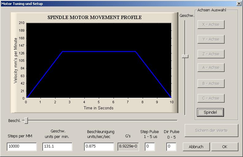

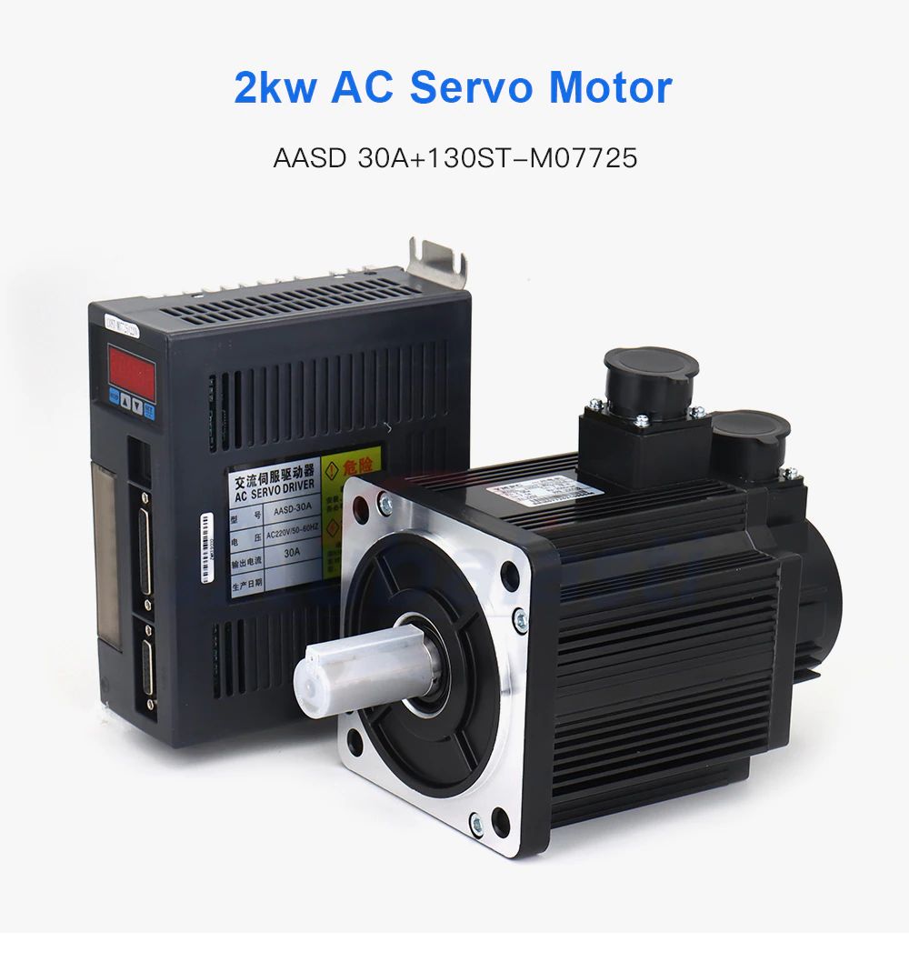

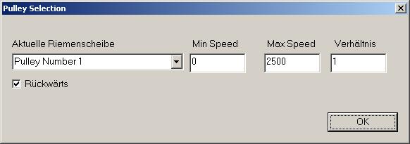

Hi there,
who can help me with LinuxCNC of the servo spindle, which ran with Mach3 without any problems?
Servo Motor: 130ST-M07725
Driver: AASD 30A
I operated the spindle at Mach3 via step ind dir pin which also worked. Now I wanted to switch to LinuxCNC and I can't get the spindle to run.
I've already tried different settings in StepConfig, but it didn't work.
Attached are the pictures and from Mach3 .hal and .ini and servo motor.
What does the hal have to look like for the servo spindle to run?
I would be very happy about suggestions.

Not sure but there a few older threads about this:
forum.linuxcnc.org/49-basic-configuratio...663-spindle-step-dir
So looks like you will need to set up a stepgen in velocity mode. For that you might need to edit the hal file directly.

Hello Aciera, Thank you for this information.
I also read and tried this thread, but that doesn't work either.
