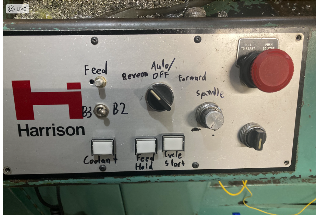

Right now I have the spindle forward and reverse hooked up to this switch, but the middle position is simply no signal, therefore I must turn the spindle off by clicking the button on the screen. I think I could use a NOR gate connected to the two signals on the mesa board to determine when to trigger the manual spindle stop, but I really don't know how to implement this in the HAL file or if I need to use something like classic ladder. Your help is greatly appreciated. HAL file and picture of lathe control panel attached.

Thanks for the advice, I'll try to implement it. I don't know how to do this with the 2nd way you described, the spindle drive takes an enable signal and a forward/reverse signal from the Mesa 7i76E so there isn't an easy way to hook up directly to the drive.

Ok I've implemented the or2 and not into my hal file. I'm getting an error now, "Signal name 'not.0.in' must not be the same as a pin. Did you omit the signal name?
I don't know why I'm getting this.

It works! Here's the solution
net spindle-manual-cw <= hm2_7i76e.0.7i76.0.0.input-28 => or2.0.in0
net spindle-manual-ccw <= hm2_7i76e.0.7i76.0.0.input-27 => or2.0.in1
net arf not.0.in <= or2.0.out
net spindle-manual-stop <= not.0.out
the letters can be anything.
