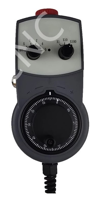

Hi All,
I need help figuring out my MPG.
I have the standard cheap Chinese MPG (see pict) and I have it mostly working.
I am running a Rasp Pi4B with Mesa 7i76e.
My HAL is 100% from PNCCONF with no customization as of yet.
Axis are set as XYYZ and I think that may be messing wit the PNCCONF setup.
Seems like my attached HAL is close based upon reviews of other similar HAL from the forum.
The following will show as working in HalShow when selected:
jog-incr-a,
jog-incr-b,
jog-incr-c,
axis-selected-count - this increases and decreases as the wheel is spun
axis-select-x
axis-select-y
axis-select-z
joint-select-a
joint-select-b
joint-select-c
selected-jog-incr changes to selected value
A lot of the connections are made, but something is just not connected.
What am I missing that will link it all together?
I think line 346 needs to be to joint.3 , but need a second opinion. I don't believe this is the overall issue.
Thanks in advance for the help.
Tim

So I have been working on this occasionally and have re-checked everything.
My issue is that I can not get the axis to enable.
Originally I reported that they did, but I don't believe that was correct.
So all the above is correct except that the signals:
axis-select-x
axis-select-y and
axis select z
and the connected pins:
axis.x.jog-enable
axis.y.jog-enable and
axis.z.jog-enable
do not enable (via HalShow) when the individual axis are selected on the MPG.
I have been trying to read and understand the differences between what Bob supplied and all the other examples, but I can't sort it out...
Can anyone explain why these would not enable from the HAL originally attached?
Thanks so much, Tim

27 Sep 2022 12:34 #252854
Replied by andypugh on topic MPG setup on XYYZ
Looking in your HAL I see
But nowhere do I see anything that connects those to an output from the MPG
It looks like the inputs are meant to be here:
But those are using different signal names, so won't pass the values to where you want them.
First note that the "signal" names (the first thing after the net) can be anythign at all, there are no magic values that will automatically connect things up.
But, any "net" commands with exactly the same signal value will cause all pins in the net to take the same value.
So, I think that the fix is for you to change the a, b, c to x, y, z. But be aware that they only need to be the same, you could stick with a, b,c everywhere as long as it was consistent, if you really wanted to confuse future-you.

28 Sep 2022 00:29 #252903
by Hammerbot
Replied by Hammerbot on topic MPG setup on XYYZ
Andy,
Thanks so much for the help.
I just needed someone to explain it to me like I am a 40 year old kindergartener...
Changing "joint-select-a" to "axis-select-x" and both the other 2 like that (y, z) made all the difference.
Working now and love it.
My HAL was almost directly out of PNCCONF. This seems like it was missed with the update from Axis to Joint in the prior update.
Thanks again for the help. Tim
