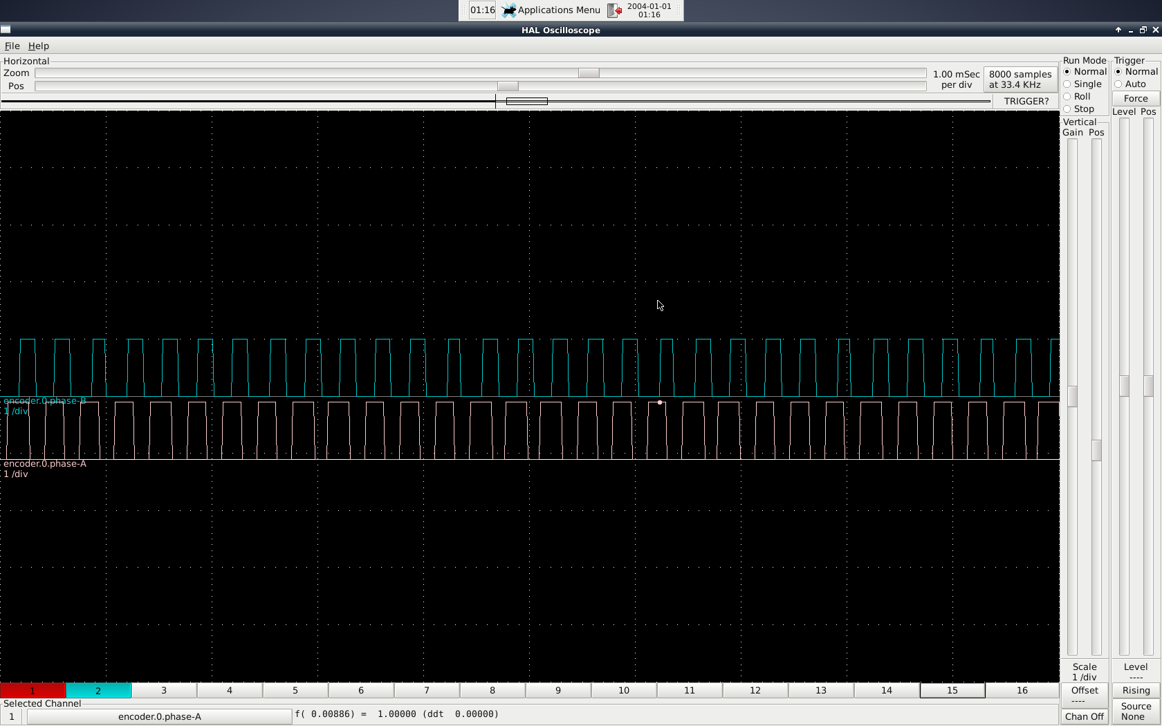

When I perform a G76 cycle, the machine does all it should do, but the threads looks weird, like each pass started in a random position. At first, after configuring the encoder in stepconfig I found the Index was inverted and that made sense, but after inverting the signal it still looked weird.
Got a couple of parts that looked like buttress thread and thought that I may have the compound angle parameter wrong (Q), since I was doing OD thread with an ID tool going backwards. But still did not work either with Q30, Q0 or Q-30. Found somebody with a similar looking issue:
www.forum.linuxcnc.org/38-general-linuxc...ions/38627-g76-issue
Then added the "near" component to the spindle speed to activate the index-enable. Althought it shoulnd't be needed as the threading was starting, I got even more random thread starts.
I'm using LinuxCNC 2.7.14 on parallel port, not ideal but it's fast enough (400rpm at 360ppr) as I have not been able to update this old PC to a newer version. Have adjusted the encoder pots to get the cleanest A/B/Z signals and they look really great on the halscope, plus the pitch is perfect.
Don't think is backlash either, as it's always going in the same direction and would be compensated at thread start. Have also checked for noise in the Index signal, but looked perfect in halscope.
My last bullet will be to do try a "threading without index" component.
This is my HAL file:

Decided to do some more checking. Put an indicator on the chuck jaw and rotated the spindle by hand one turn, then other turn backwards, until encoder.rawcounts in halmeter went back to 0. The indicator shows that did not went back to original position maybe by a couple of degrees. Encoder is 360ppr in quadrature so the error is bigger than the resolution, seems that I'm loosing a few counts.
I have tried duplicatin the base-period just in case I had some unexpected high jitter, also deleted the parport reset time, but again same result.
Funny thing is that it seems to loose steps always in the same direction, no matter what direction I rotate the spindle first. Anyways this error is small and does not fit the random start I'm getting, at least on the start of the thread.
I will check again the A/B sinals in halscope. Also will connect the encoder to the MESA 7i76e of my mill to discard problems either on the encoder or the lathe BOB.
- DEVILHUNTER
- Posts: 31
- Thank you received: 11
Also checked the halscope log. I can se how there is at least two readings per quadrature phase change so should be enough for LinuxCNC to read all encoder pulses.

Both encoder and spindle pulleys are made from the same CAD file. Belt is HTD and the pulleys are press fitted, so the relation is 1:1 for sure. Also checked again in halscope the shape of the index signal and I see a clean signal, evenly spaced and without noise.
Connected the encoder to my 7i76e and checked the movement with the comparator against the chuck jaw. Turned the spindle a few turns in one direction, reading the encoder rawcounts each turn. Then turned it back to 0. Still see some error in the numbers but not too much, a few counts.
This weekend I will connect everything to the 7i76e and do a fresh config on my mill computer with LCNC 2.8.0
- Posts: 21827
- Thank you received: 7453
That points to encoder interference or fault, do you have another encoder to test with?Turned the spindle a few turns in one direction, reading the encoder rawcounts each turn. Then turned it back to 0. Still see some error in the numbers but not too much, a few counts.
