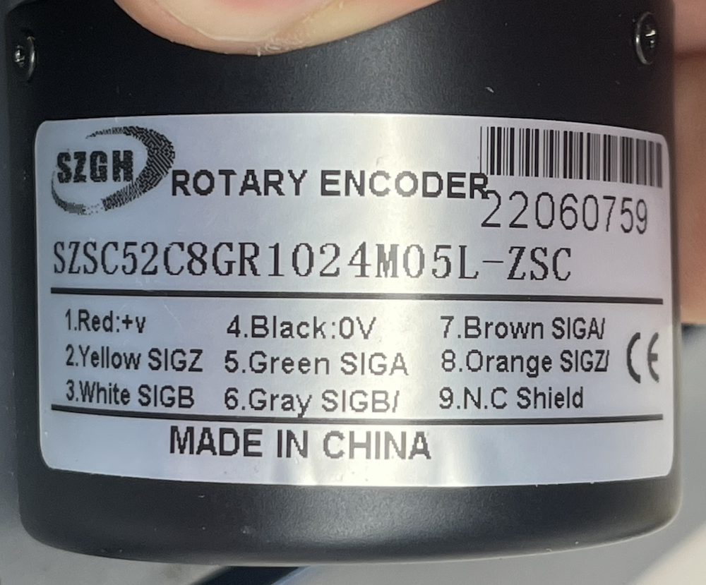

I bought a rotary encoder for my emco lathe.

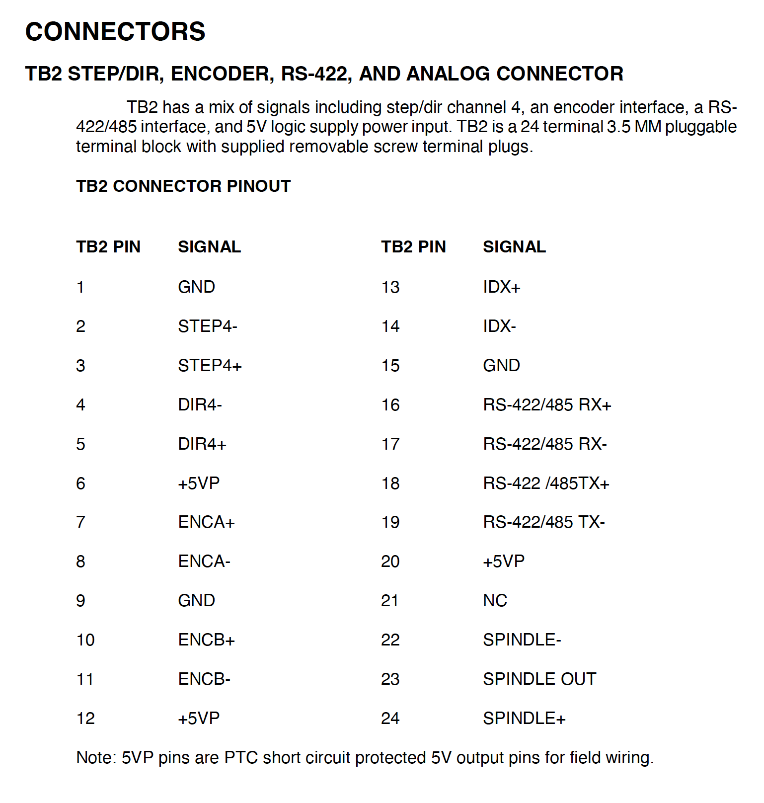

I connected it to 7i96s card
red wire -> pin6 (+5VP)
black wire -> pin9 (GND)
green wire (SIGA) -> pin7 (ENCA+)
brown wire (SIGA/) -> pin8 (ENCA-)
white wire (SIGB) -> pin10 (ENCB)
gray wire (SIGB/) -> pin11 (ENCB-)
yellow wire (SIGZ) -> pin13 (IDX+)
orange wire (SIGZ/) -> pin 14 (IDX-)
Is this connection right?
How to modify my hal and ini files?

- Samuelx
- Posts: 56
- Thank you received: 4
06 Sep 2022 19:53 - 06 Sep 2022 19:56 #251344
by Samuelx
Replied by Samuelx on topic Lathe rotary encoder mesa 7i96s
Is this anything close to be right if I add this to hal file?
