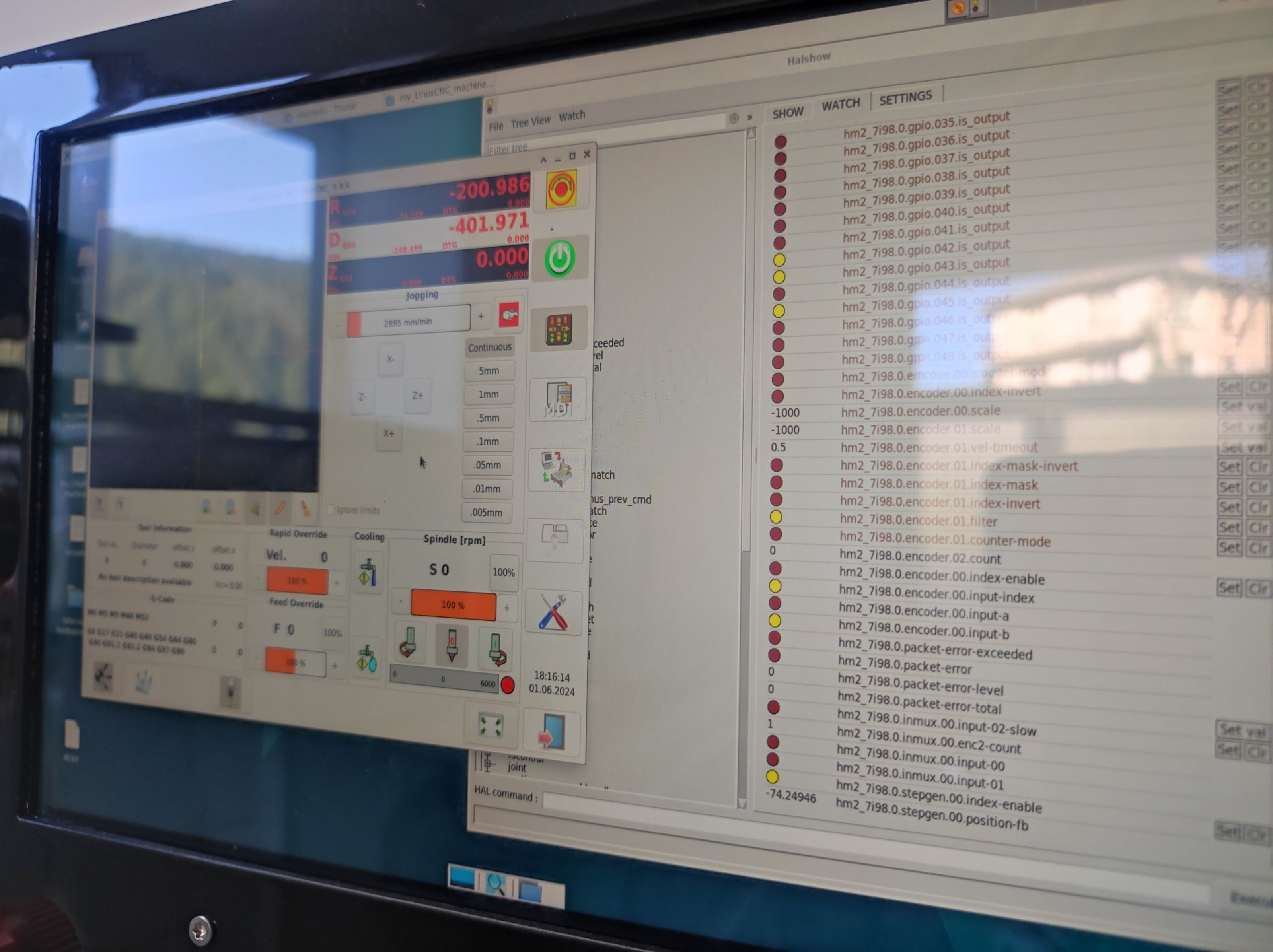

I just uploaded the wrong example here. Uploading the Pin file. You may see something wrong.
Without the included index, the machine is HOME close to the switch. When the index is on, the machine moves to the Home switch and then returns 26-45mm.
PS. Now I tested the motor index for repeatability and every time in halshou pin stepgen.00.index-enable clears at the same position. It is not a problem in the driver and reading the signal. Maybe something in the ini file is missing or wrong? When the index is turned on, the Axis returns at the time of starting the HOME procedure And the speed is high

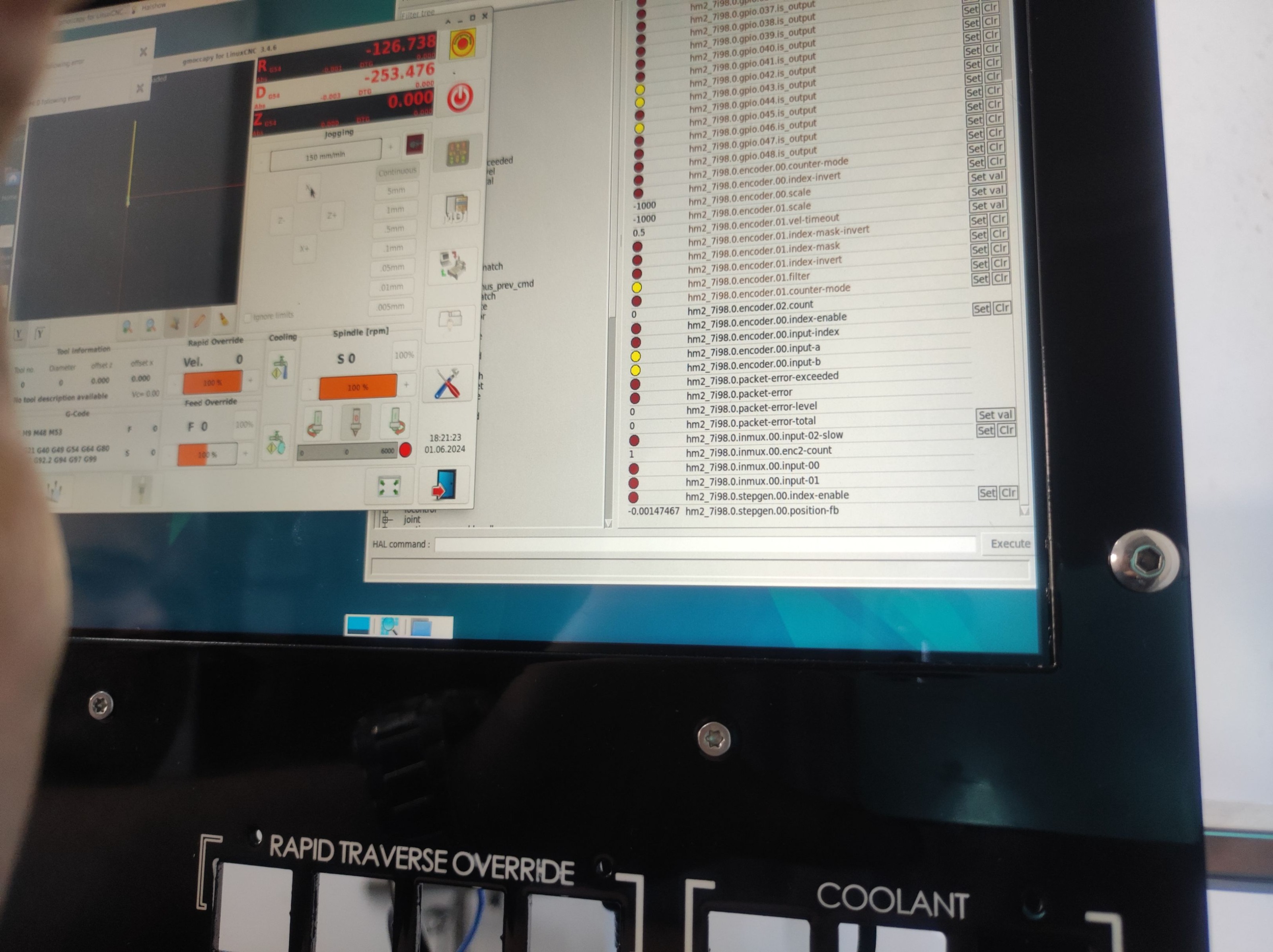

Can you post your current hal/ini files?
Also you can verify index operation by
1. Watching the stepgen feedback position and stepgen index enable in halshow
2. "sets" the stepgen index enable signal
3. Generate an index event
The expected result is that on index event, the stepgen index enable will go false
and the stepgen feedback position should be zeroed.

I think I found the error. When I have duplicated the X axis to make the Z axis. I forgot to change a few Z-specific names .
Here are the wrong lines in Z configuration :
net x-index-enable joint.1.index-enable <=> hm2_7i98.0.encoder.00.index-enable
Thanks again for your help!
