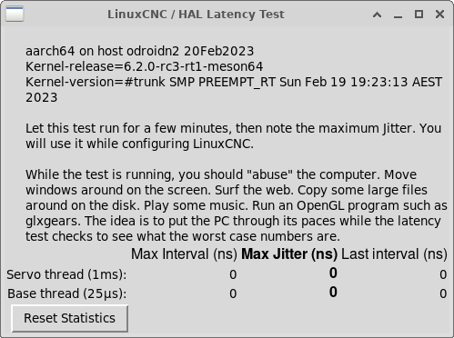

Seen here when loading axis_mm sim on RIP linuxcnc on Armbian OS on Odroid N2
The system is likely broken, but I have no clue where to look.
It may be related but there is no data in latency test. Odd
USRMOT: ERROR: command timeout
emcMotionInit: emcTrajInit failed
waiting for s.joints<0>, s.kinematics_type<0>
Waiting for component 'inihal' to become ready..waiting for s.joints<0>, s.kinematics_type<0>
.........USRMOT: ERROR: command timeout
...waiting for s.joints<0>, s.kinematics_type<0>
.................USRMOT: ERROR: command timeout
.........A configuration error is preventing LinuxCNC from starting.
More information may be available when running from a terminal.
.Shutting down and cleaning up LinuxCNC...The system is likely broken, but I have no clue where to look.

Replied by rodw on topic What causes USRMOT: ERROR: command timeout| emcMotionInit: emcTrajInit failed
Nah, the processor is current, just its a 6 core ARM64 CPU.
I've worked it out now. The PREEMPT_RT patch I built is broken.
Linuxcnc works perfectly before I apply the RT patch.
So back to the drawing board!
