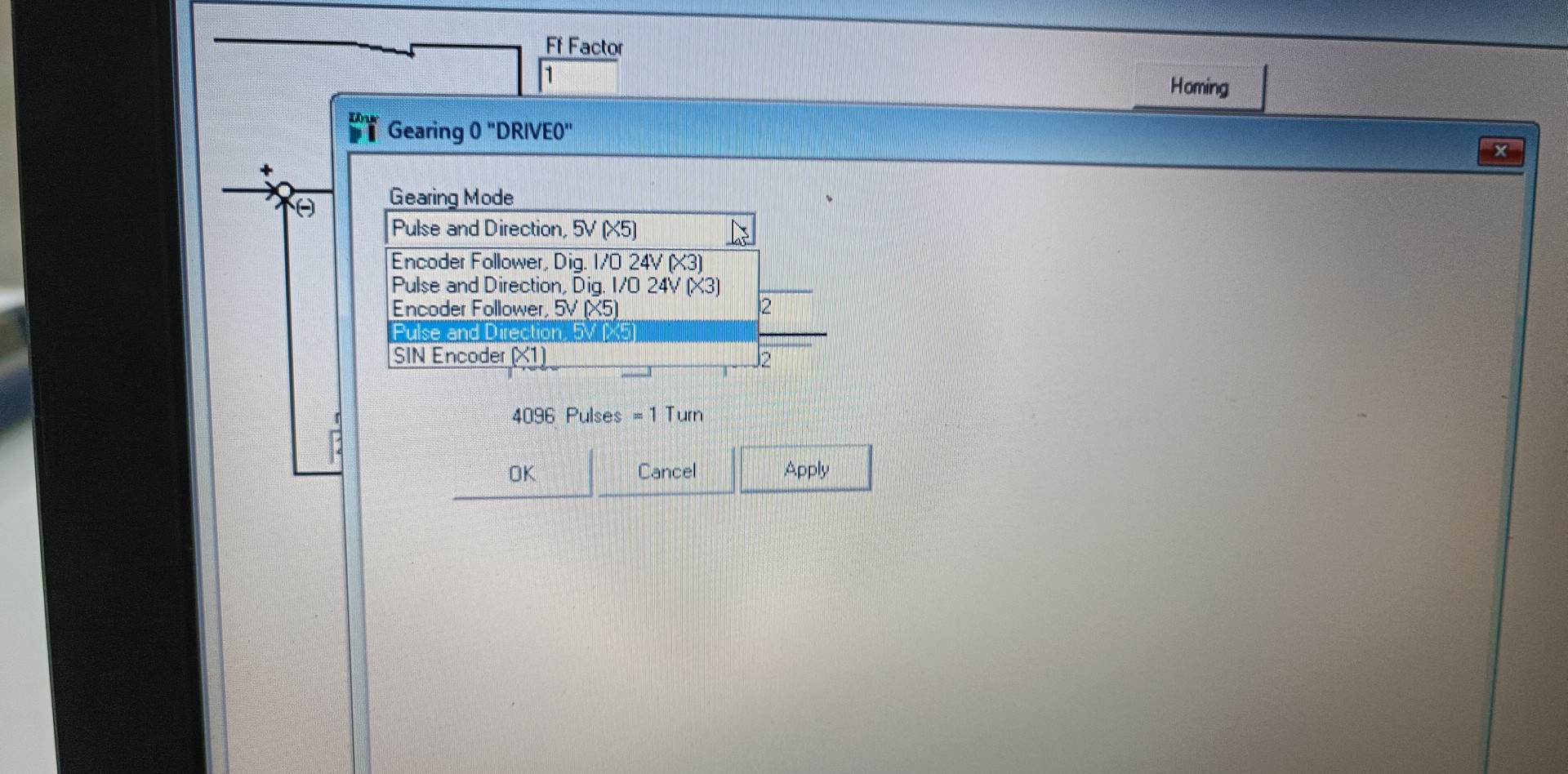

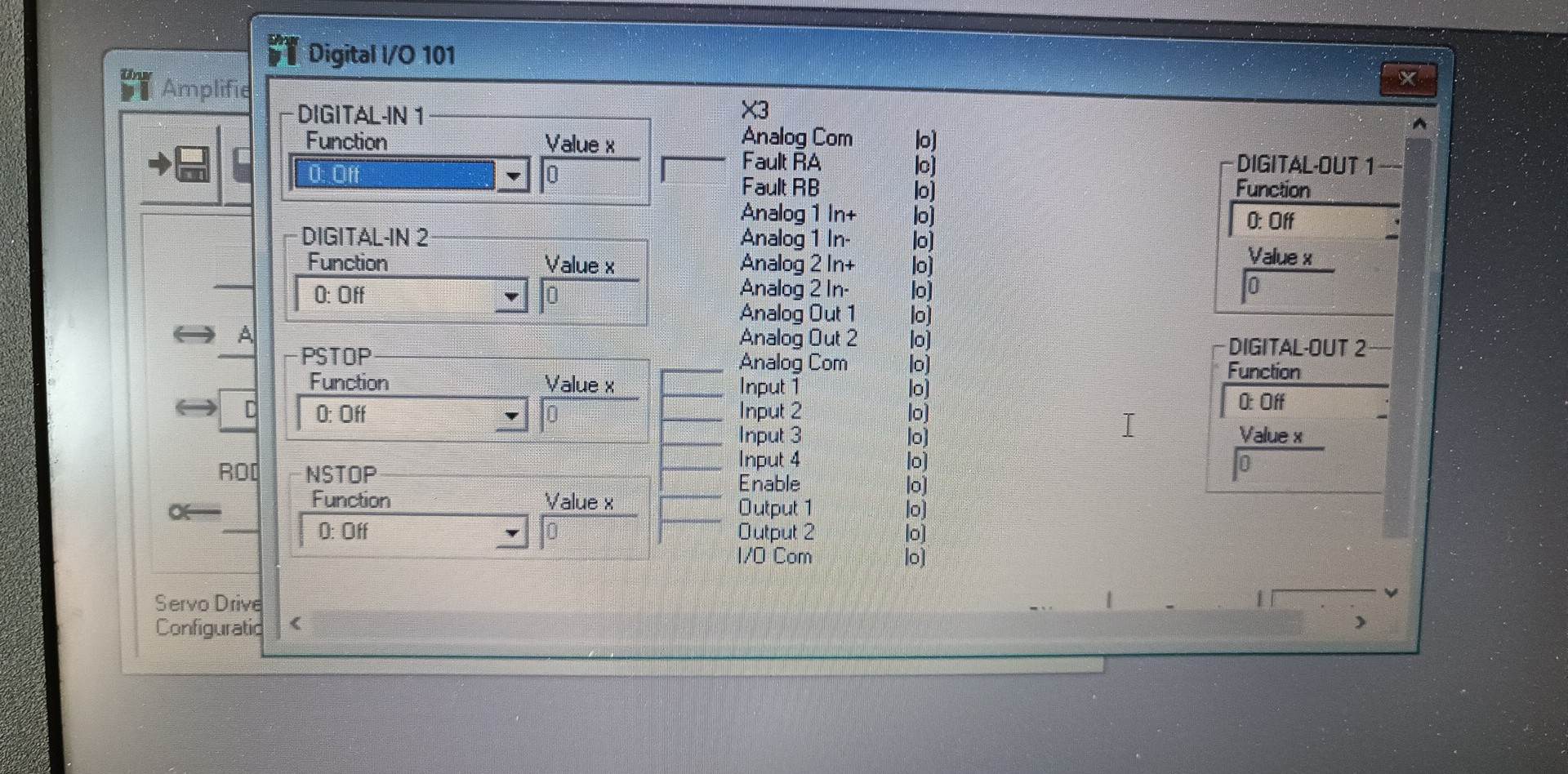

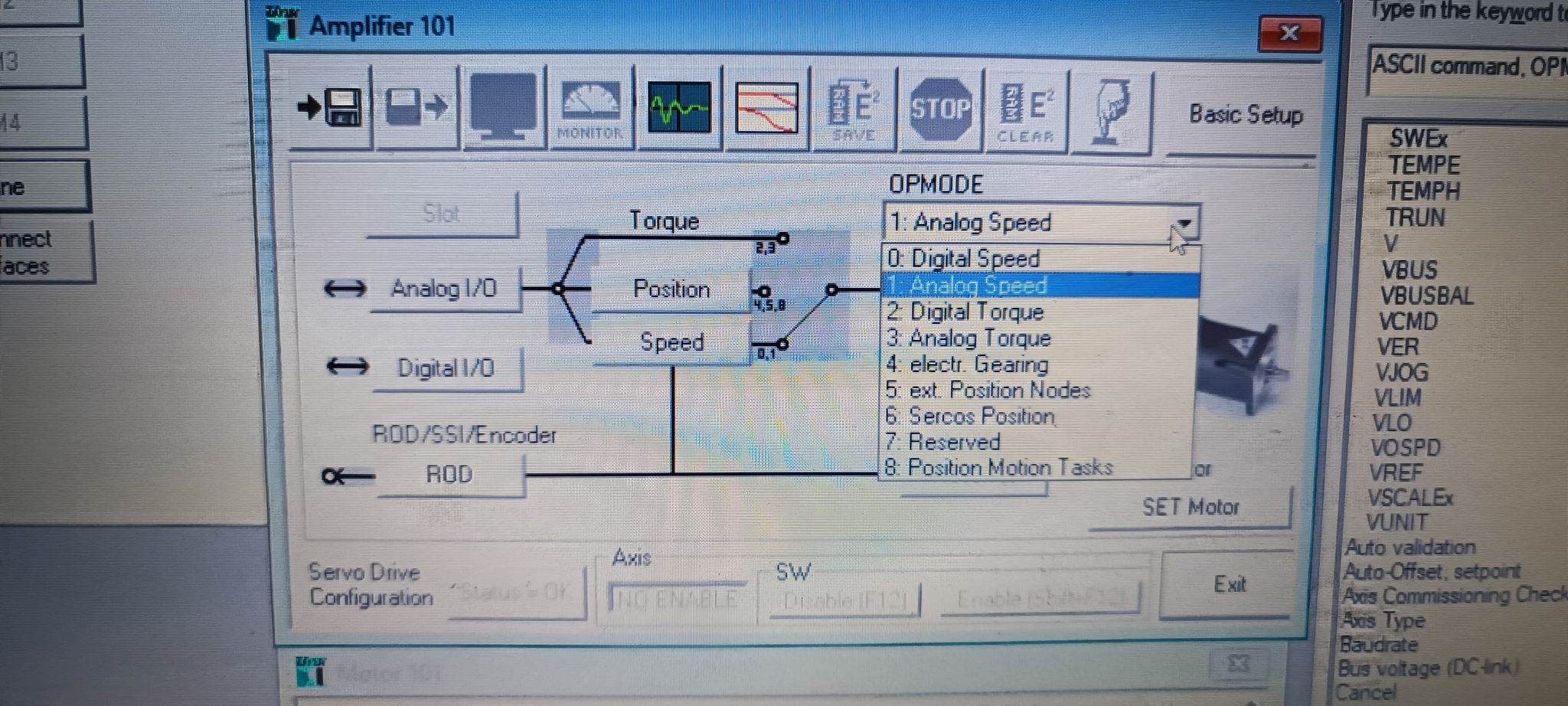

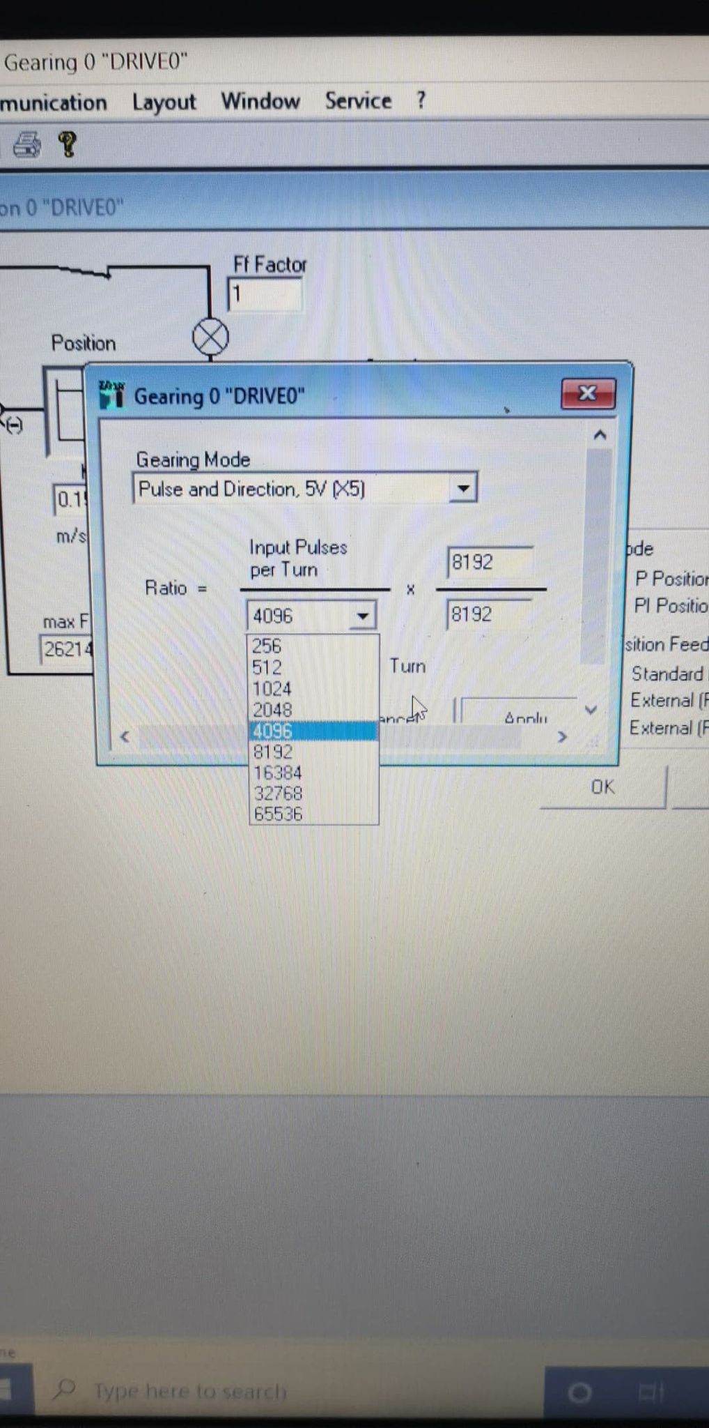

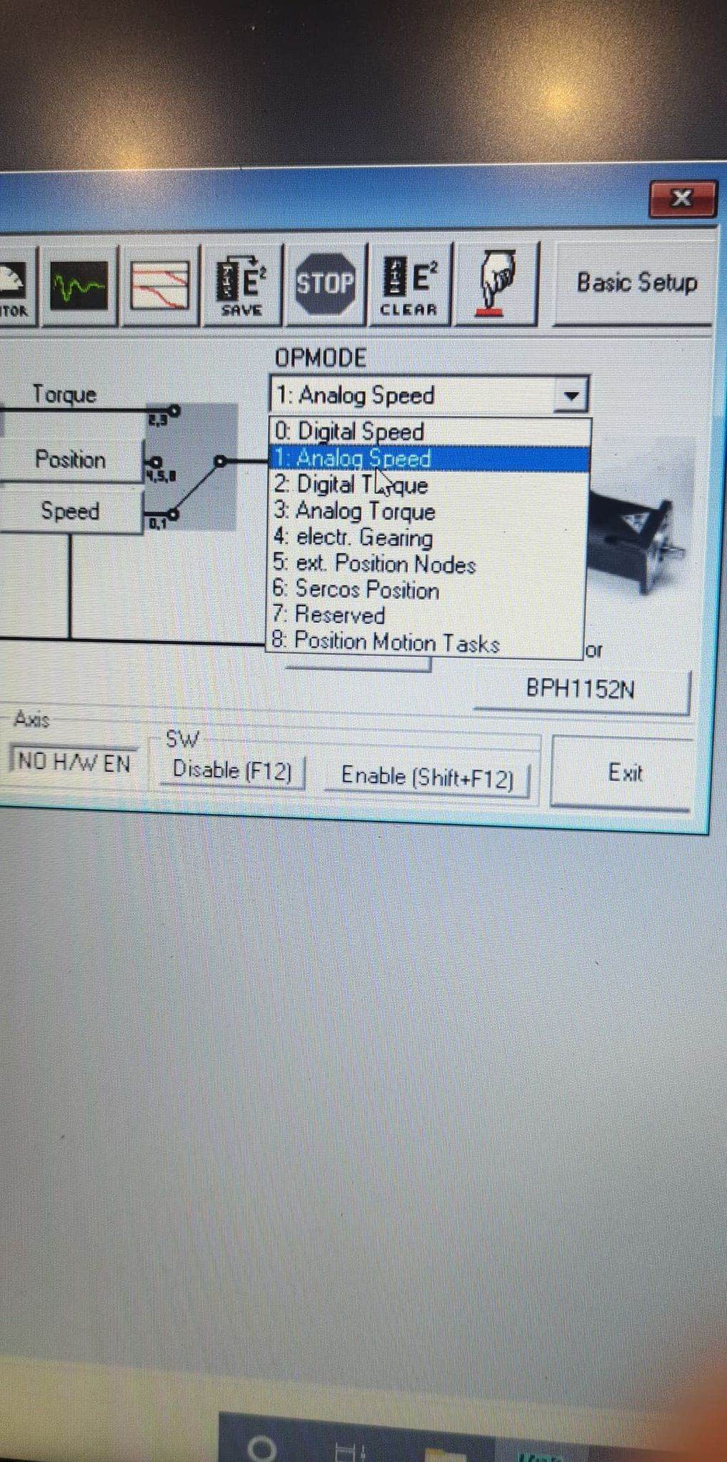

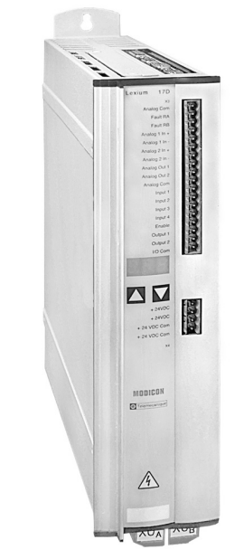

Hello. I recently got a Modig md5000 without drivers and motors.
I have 4 Schneider Modicon Lexium 17D driver kits that I am trying to use for it.
At this moment I got stuck with the parameterization of the drivers. I want to command them with STEP/DIR.
The driver software I use is Unilink.
At this moment, I have connected the drivers with the motors, I have set them for the step/dir command, but I cannot move them
I am attaching the drivers manual, and pictures of the Drivers.
I guess I need some help with the parameterization of the driver.

Replied by tommylight on topic Modicon Lexium 17D driver - help
No info there on how to set the drive to position mode, see if you can find that in software.
Try
Digital IO > position > digital speed

I have the same problem and can't find any information. No matter how much I read the manual, I can't understand how to make the motor turn. If you have a tutorial made, or an example, I would greatly appreciate it. Thank you.

Guys? Have You solved the problem ? I wants to use them too but i'm stuck with the settings.
