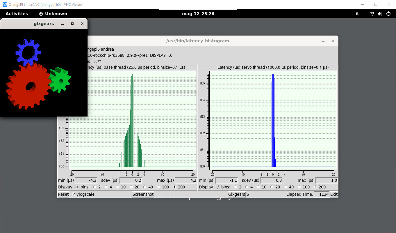

- Guglielmi
- Posts: 78
- Thank you received: 17
11 May 2023 16:08 #271165
by Guglielmi
Replied by Guglielmi on topic New GPIO driver for OPI5
I will post a screen-shot as soon as I back at home.
I remember it was around 3us running for more than 2000 seconds, with 6 gears running
How much you can reach with H3?

12 May 2023 21:29 #271253
by Guglielmi
- Posts: 12156
- Thank you received: 4149
12 May 2023 22:42 #271262
Replied by rodw on topic New GPIO driver for OPI5
Amazing!

14 May 2023 17:09 #271352
by mwidlok
Replied by mwidlok on topic New GPIO driver for OPI5
The results are really good. If I remember correctly it was more then ~30us with H3. Now on normal T530 laptop I'm getting ~15us with hard load (firefox, kicad, solvespace), but we all know that notebooks are poor choice for real time.
Are You using any special tweaks for the OPI5 (like isolcpus or something)?
