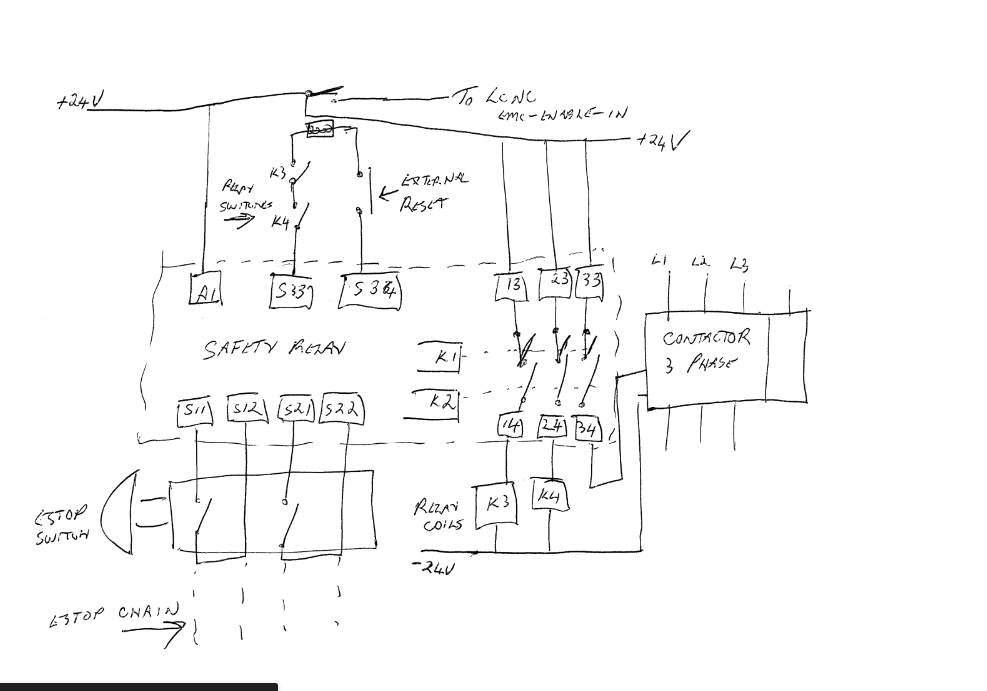

I'm assuming you have an external safety relay with a pushbotton for estop reset.
Your estop reset button should trigger a relay which sends field power to a input connected to
iocontrol.0.emc-enable-in
<code>
net Machine-On = hm2.7i96.0.gpio.001.in
net Machine-On = iocontrol.0.emc-enable-in
</code>
Your ssafety relay may look a bit different to this but here is mine
<code>
</code>
Last edit: 11 May 2023 09:26 by rodw.

Rod,
I have a sole-person hobby shop running a simple conventional mill.
My judgment is that I don't need a sophisticated safety relay.
My arrangement has simple relays with:
- a latching E-stop button that drops the E-stop relays,
- the steppers are de-energized,
- the spindle does a fast stop,
- a signal is sent to I/O.
Re-start requires:
- reset of the E-stop button,
- initiate Machine On with either:
- mouse select Machine On button on the Axis Command Line,
- operate a Machine On push button on the operators control panel.
I haven't yet picked up on the subtle difference between the various Hal signals.
My solution uses 'halui .machine.on', you seemed to have used 'iocontrol.0.emc-enable-in'.
Are they different ? I will dig into the documentation.
John.

halui is exactly that. a hal ui so it has all the buttons a HMI panel needs.
iocontrol is about machine control (including estop)
