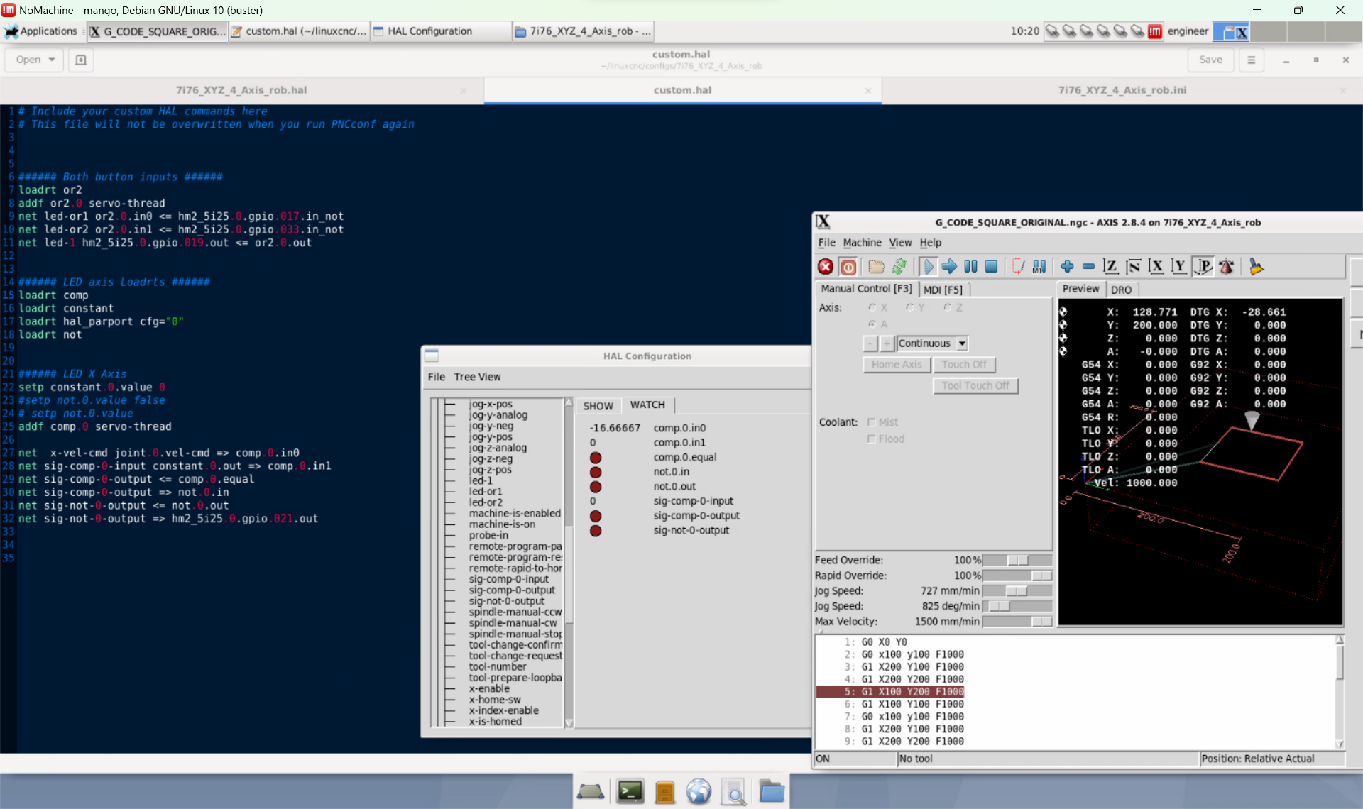

The NOT function is not behaving as expected. Despite any changes in the input signal, the output is always false. I am trying to set up an LED to remain lit while the X-axis is moving
The hardware that I am using is a 5i25 card with a 7i25 daughter board and a 7i25 protected breakout. I am using the protected breakout to control some LEDs and a few button inputs and the daughterboard for controlling the CNC.
Code
screenshot while CNC was running
Any help will be appreciated. Thanks in advance
Code
###### LED axis Loadrts ######
loadrt comp
loadrt constant
loadrt hal_parport cfg="0"
loadrt not
###### LED X Axis ######
setp constant.0.value 0
addf comp.0 servo-thread
net x-vel-cmd joint.0.vel-cmd => comp.0.in0
net sig-comp-0-input constant.0.out => comp.0.in1
net sig-comp-0-output <= comp.0.equal
net sig-comp-0-output => not.0.in
net sig-not-0-output <= not.0.out
net sig-not-0-output => hm2_5i25.0.gpio.021.outscreenshot while CNC was running

Replied by tommylight on topic NOT function not working
Missing
addf not.0 servo-thread

by JPL
Replied by JPL on topic NOT function not working
...And I believe missing too:
addf constant.0 servo-thread

Replied by Greshr on topic NOT function not working
Thanks, I thought it would be something straightforward.
- MaHa
- Posts: 537
- Thank you received: 235
02 Jun 2023 11:09 #272699
by MaHa
Replied by MaHa on topic NOT function not working
I think, you don't even need constant.
should do it also
setp comp.0.in1 0should do it also
Missed that, need bigger glasses!...And I believe missing too:
