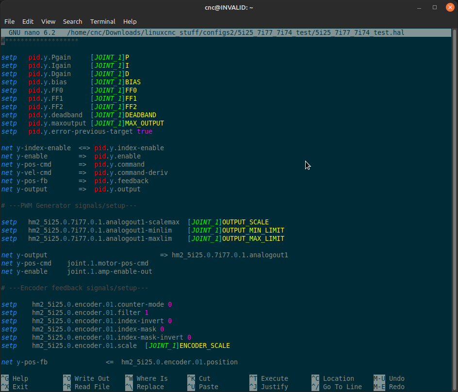

Syntax Highlighting for HAL in Nano was created by MrRekt
I made this as a learning exercise as I read through the HAL man pages. I figured someone here might make use of it - perhaps even help me improve it.
Of course, it'll look different depending on how you have your terminal set up, but on mine it looks like this:
If you haven't already, you'll need to enable syntax highlighting for Nano. One way to do this is by opening /etc/nanorc and finding and un-commenting the second line below:

18 Jun 2023 23:27 #273817 by tommylight
Replied by tommylight on topic Syntax Highlighting for HAL in Nano
OK, i juts gave it a try and it works:
Thank you.

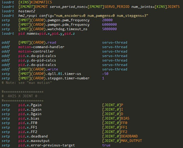

20 Jun 2023 17:56 - 20 Jun 2023 18:12 #273952 by MrRekt
Replied by MrRekt on topic Syntax Highlighting for HAL in Nano
A couple of quick fixes:
  • Regex fix where "unload" would match before "unloadrt", which wouldn't highlight the whole word (and similar cases)
  • Highlighted axis/numeric parts of names will now be highlighted if only separated by a "." (as in tommylight's screenshot)
  • Everything following commands starting with "load" or "unload" will now be italicized unless otherwise formatted (as opposed to just "loadrt")
  • Added a couple more components I missed.

    Let me know as you find other things to be improved.
