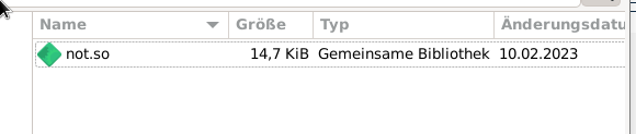

Thanks for the quick feedback. So quickly I do not come to all the proposals around and to answer the questions.
I have tried again, and have now arrived at another error. It does not find the module not.
However, in the described folder I can find the not.so.
I have attached the error report and the current HAL.
Thanks a lot
Thanks a lot

21 Jun 2023 23:06 #274014
by pippin88
You load a 'not' called 'not.0', but then you are trying to use a named 'not' called 'not.spindle_enable'
Either define the 'not' as named
"loadrt not names=not.spindle_enable"
Or work with not.0 (no name)
Replied by pippin88 on topic Manual pneumatic tool changer
loadrt not.0
loadrt and2
addf not.0 servo-thread
addf and2.0 servo-thread
net spindle-enable => not.spindle_enable.inYou load a 'not' called 'not.0', but then you are trying to use a named 'not' called 'not.spindle_enable'
