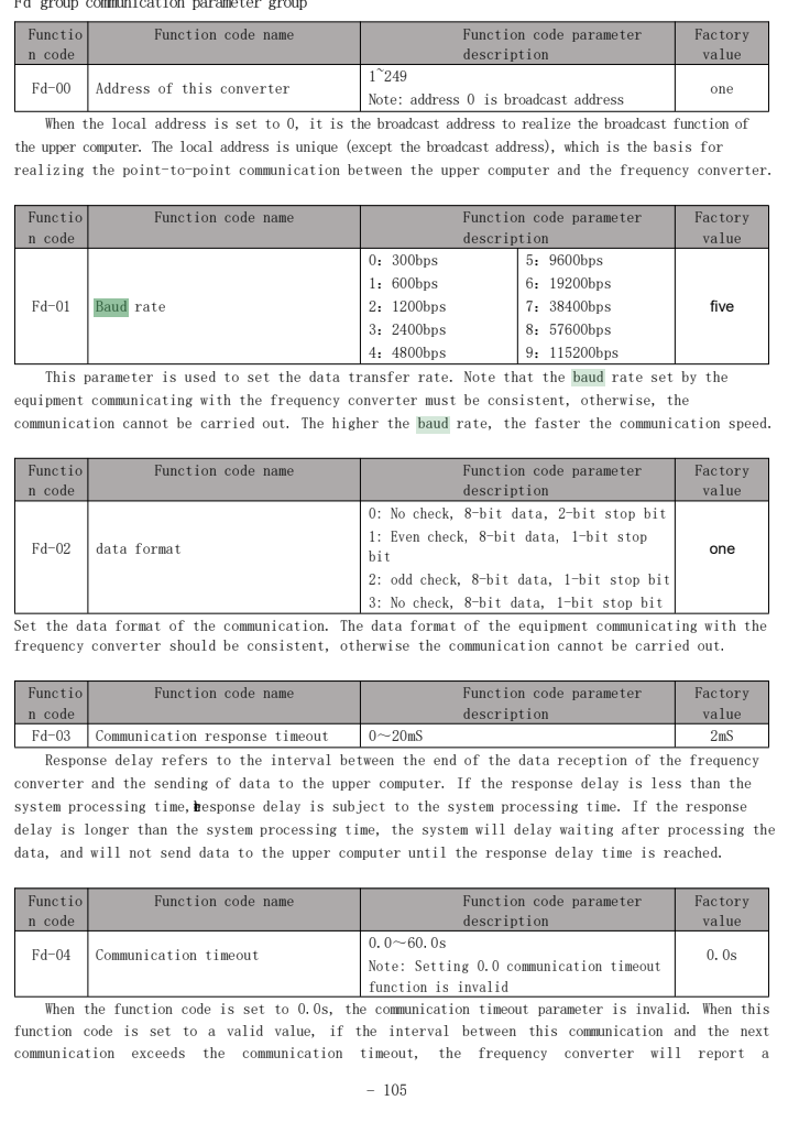

The vendor was able to supply a PDF of the complete manual! I've attached it here. Oh no! It's too big (3.4mb) - here is a google drive link:
Manual Translated
. It's clearly a auto-translated from Chinese, but it looks like it's all there.

Only thing I can come up with is the com settings as you this in the mb2hal.ini:
So maybe you changed Parameter Fd-02 to option '0'
If you have not then the factory setting (Option '1') would be:
[TRANSACTION_00]
LINK_TYPE=serial
SERIAL_PORT=/dev/ttyUSB0
SERIAL_BAUD=9600
#Data bits. One of 5,6,7,8.
SERIAL_BITS=8
#Data parity. One of: even, odd, none.
SERIAL_PARITY=none
#Stop bits. One of 1, 2.
SERIAL_STOP=2
#Serial port delay between for this transaction only.
#In ms. Defaults to 0.
SERIAL_DELAY_MS=150
MB_SLAVE_ID=1So maybe you changed Parameter Fd-02 to option '0'
[TRANSACTION_00]
LINK_TYPE=serial
SERIAL_BAUD=9600
SERIAL_BITS=8
SERIAL_PARITY=even
SERIAL_STOP=1
SERIAL_DELAY_MS=150
