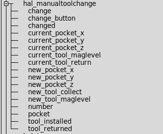

Im working on a automatic tool changer and have decided to adapt code from the hal_manualtoolchange component that already exists. Mostly because this solves the "what if the tool asked for is not in the magazine" question already.

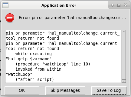

Anyway. I have added more hal pins to the component and they show up fine in hal show (see attached image). however when i write a command to one of the outputs from the python script i get an error saying that "pin or parameter xxxx not found" (see attached image)
The original hal pins from the base script work fine however. Do i need to add the pins somewhere else as well to get things rolling?

I have played around with connecting the pins in different stages of boot with no luck.
I also realized i may have been a bit unclear as to the nature of the error.
The error i have attached a image of in the first post is generated when i run a setp command i hal show. Its not really related to when the pins are being connected to each other or not. To be able to run the setp i had to comment out the connection in hal file. Otherwise it wouldn't let me run the setp command at all. Maybe this narrows down the problem a bit more.
The same error occurs when the python script tries to alter the state of that same pin. (with it connected in hal file)

02 Jul 2023 22:14 #274667
Replied by andypugh on topic Python HAL script, Pins not working
You can't "setp" a pin that is connected to a signal.
You can "sets" the signal, unless it contains a writer (ie, HAL "out" pin)

03 Jul 2023 08:47 #274683
Are you using "hal getp" and "hal_setp" in the Python script? That seems strange, as you would normally access the pin values for pins "belonging" to the component as variables.
eg
eg
