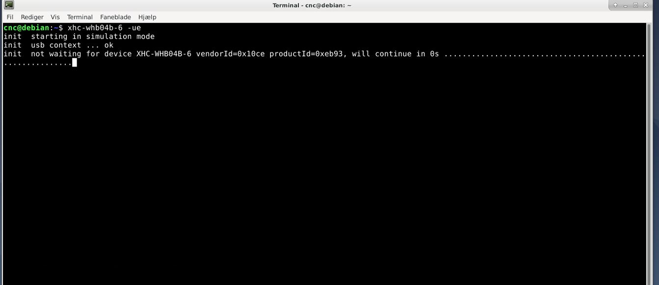

hello,
i was following this guide for the XHC-WHB04B pendant
forum.linuxcnc.org/24-hal-components/450...xhc-whb04b-4-pendant
and when i run the simulator in terminal it just doing this :
cnc@debian:~$ xhc-whb04b-6 -ue
init starting in simulation mode
init usb context ... ok
init not waiting for device XHC-WHB04B-6 vendorId=0x10ce productId=0xeb93, will continue in 0s .......................................................................................................................................................
when i cancel it :
init not waiting for device XHC-WHB04B-6 vendorId=0x10ce productId=0xeb93, will continue in 0s .......................................................................................................................................................^Ctermination requested upon signal number 2 ...
ok
init XHC-WHB04B-6 device found
HAL: ERROR: exit called before init
cnc@debian:~$
someting wrong whit the driver ?
runing Linuxcnc 2.10

got it,
moved the 99-xhc-whb04b-6.rules file to /etc/udev/rules.d/
github.com/machinekit/machinekit/blob/ma...9-xhc-whb04b-6.rules

if you have followed the guide forum.linuxcnc.org/24-hal-components/450...xhc-whb04b-4-pendant
and still can´t get data flow from the pendant, is that the rule file may be missing
you have to inset the file --> 99-xhc-whb04b-6.rules <-- into folder /etc/udev/rules.d/

Have found it:
#net machine.is-on halui.machine.is-on whb.halui.machine.is-on
net machine.is-on whb.halui.machine.is-on
change to:
#net machine.is-on whb.halui.machine.is-on
Error say is linked already to halui.machine.is-on
And in the basic.hal file on an long searching - there was the double link. Removed it and Now it is working.
change to:
The following user(s) said Thank You: smc.collins

If I understand correctly, then no need to remove "double links" because you loose functionality in either the pendant or somewhere else where the state of the machine is needed.
Just connect the whb.halui.machine.is-on with the signal in your basic.hal that is connected to the pin halui.machine.is-on. For example, if the signal is named MySignal then:
net MySignal whb.halui.machine.is-on
