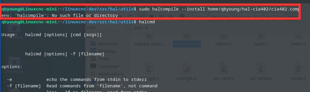

Probably would be a simple question, when installing cia402, reporting in No such file but instead halcmd works.

Should install halcompile
Replied by rodw on topic Halcompile no such file
sudo apt-get --install linuxcnc-uspace-devShould install halcompile

He is running a RIP install, so this should work:
sudo ./halcompile --install component_name.comp

With RIP, sudo is not required but it should available without installing anything provided you have run the rip-environment script
then
. ~/linuxcnc-dev/scripts/rip-environmentthen
halcompile --install mycomp.comp

Exactly, thanks, after a close of terminal, it is fixed by a rejoin of the environment
