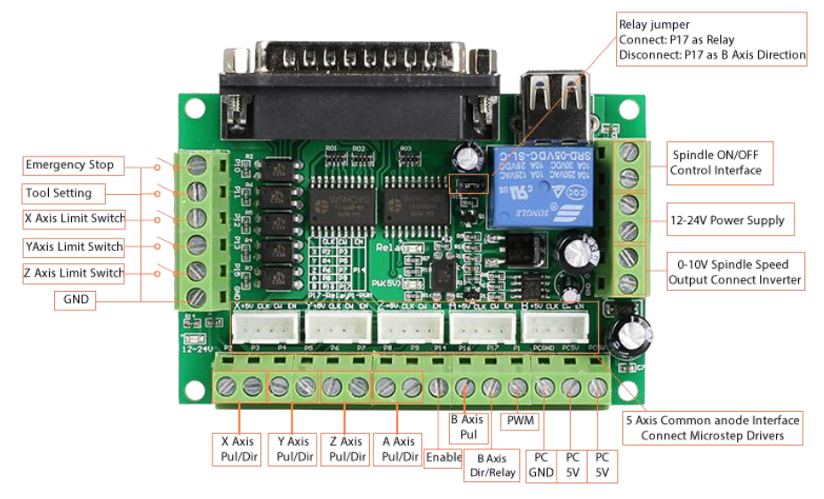

I am very new to LCNC and currently trying to figure out how to get my spindle to the correct RPM using a cheap china parport bob:
What I've got so far and this seems to be somewhat working, is what I copied from a stepconf-generated .hal file:
Do not mind if the values set in this config are odd, I am kinda lost on how to approach this so I played around with the values and checked the output voltage using a multimeter.
My spindle has 9000 rpm minimum and 24000 rpm maximum. I am planning on using a relay for spindle direction, meaning I would like to have 1% speed to to generate the voltage that is about 9000 rpm for my spindle and 100% to generate the voltage that is about 24000 rpm, but I have no idea how to achieve that.
Using the configuration above, I go to the MDI tab and put the spindle in forward at 50% rpm using M03 S12000, this results in ~5.25V on the multimeter. That should be about right. But if I put the spindle in reverse using M04 S12000, the Voltage drops to ~3.27V, when it should actually stay around 5V for half rpm. Also, if I am using M03 S8000 the measured output voltage goes up to ~7.14V. for my understanding, the higher the voltage the more rpm, why would S8000 have a higher voltage than S12000?
Also, starting the machine the multimeter shows slightly above 10V. If I start the spindle using the "spindle clockwise"-button (I am using axis), the voltage drops down to basically no spindle rpm. If I press the "[+]"-button the voltage changes, but in very small steps. I would like it to be 5% or 10% steps.

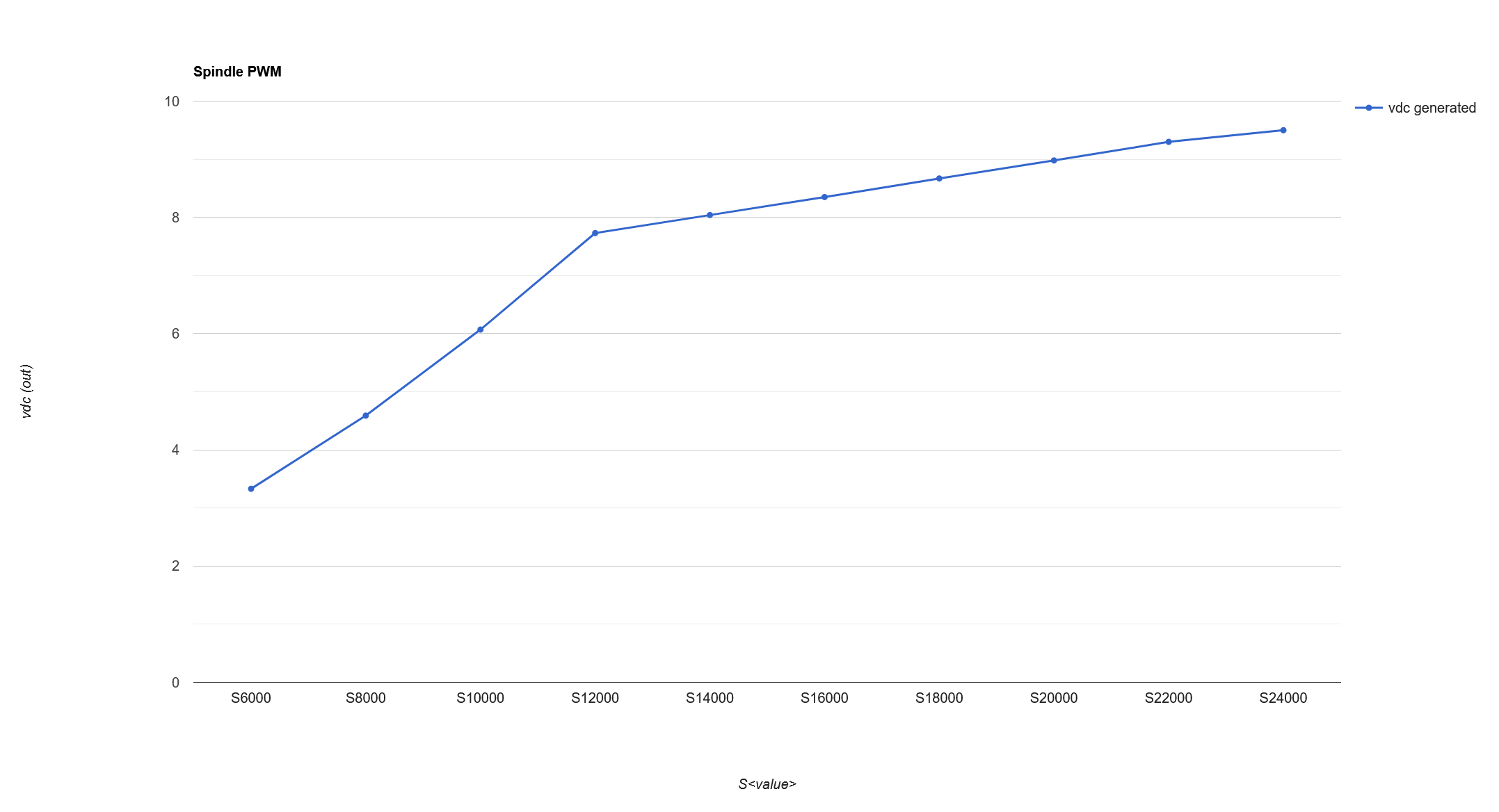

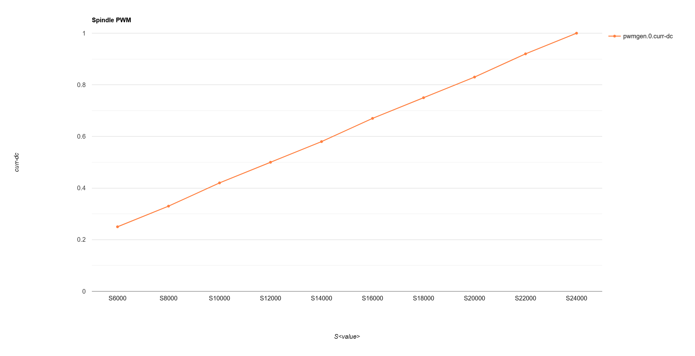

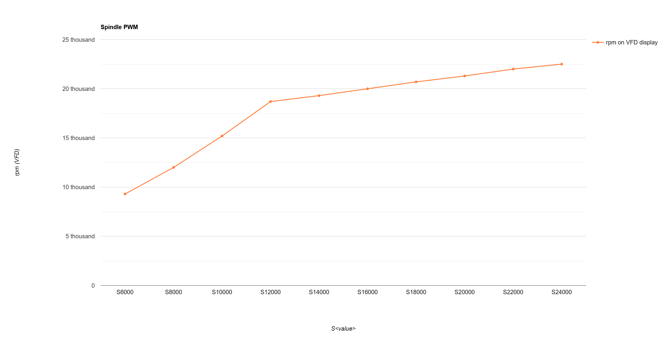

23 Oct 2023 18:29 - 23 Oct 2023 18:42 #283631
by phew
Replied by phew on topic Can someone help me setting up my spindle pwm (and soft-start)?
Hi tommylight,
thank you, I've done some testing and drew a few graphs.
Note: I ran the tests using pwmgen.0.min-dc 0.24 which results in ~9000rpm on the VFD display.
vdc:
rpm:
curr-dc:
From scimming the LINCURVE page my understanding is that I just map the values to what I need them to be, like in this example .
Other than that, the generated vdc between ~S12000 and ~S22000 appears to be quite linear. I haven't dug too deep into pwmgen.N.offset yet but I assume it can be used to shift the pwm starting point to the left and right so that only the linear part is being projected?
Is one of these solutions to be favored and if so, why?
vdc:
rpm:
curr-dc:
Last edit: 23 Oct 2023 18:42 by phew. Reason: fixed broken attachment tags

23 Oct 2023 22:02 #283640
Replied by tommylight on topic Can someone help me setting up my spindle pwm (and soft-start)?
Did you check what is the allowed minimum speed of the spindle motor?
Air cooled ones do not like to run under 8000RPM, unless they have forced air cooling provided by another fan.
Seems like "lincurve" will be best for your case, and yes it is that easy.
