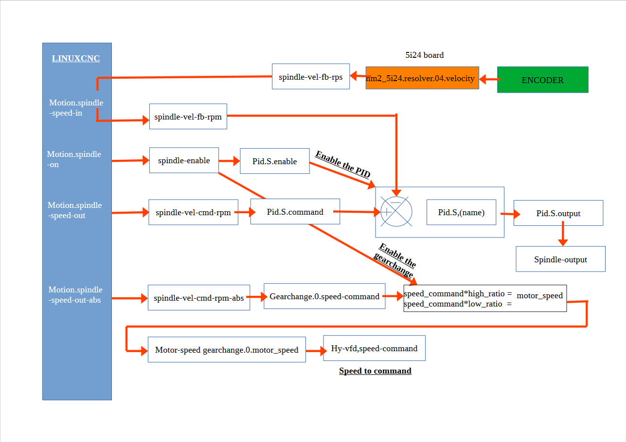

I would need your help to understand the programme to change speed according to the set point requested.
I am more at ease with graphical programming than with lines of code, so I have tried to translate the andypugh code to understand it better. Below is the andypugh code

Here is what I tried to transcribe.
My problem is that I can't understand the connection between the spindle-output signal and the hy-vfd.speed signal because one manages the speed change and the other the pid command. .
Do they have a connection that I don't know about or do these two signals have a different function?
15 Nov 2023 23:33 #285555 by blazini36
Replied by blazini36 on topic Hal gearchange for beginner
You don't have a connection between the spindle-output signal and the hy-vfd.speed signal, not in your hal file or that diagram. I'm not sure what the intentions are, maybe controlling the VFD over RS485 doesn't work well with the PID? Do you want to use the PID for the Spindle?Since your PID is fed by spindle-vel-cmd-rpm, that means it will get a negative value to reverse. spindle-vel-cmd-rpm-abs is feeding your gearchange, that signal does not go negative. I assume by this the VFD always takes a positive value for the speed and some separate binary command to reverse.
If the VFD needs the to be feed by an always-positive number use tha "abs" component after the "spindle-output" signal. Then remove the spindle-vel-cmd-rpm-abs signal and put the signal off the "abs" component in it's place to connect the PID to gearchange.0.speed-command.

16 Nov 2023 18:58 #285642 by greg23_78
Replied by greg23_78 on topic Hal gearchange for beginner
thank you blazini for your feedback,
i think i have the same machine setup as you. the VFD 0-10V will control a servo spindle (japanese spindle) with an integer encoder in the spindle.
my intention for the machine
1) to run my VFD in open loop (I understand that tuning a spindle is tricky)
2) Orient my spindle to change tool (with encoder or proximity sensor) the simplest for the moment being a beginner.
3)classic ladder for the tool change system
4) after some experience with linuxcnc go to closed loop
for your spindle, do you use mux and gates components for the orientation of your spindle (tool change) or for the rotation of the spindle ?
I have modified the diagram according to your feedback to recover only positive values. I know that in open loop I don't need PID but I would like to prepare for the servo control afterwards.
Can spindle-out work if PID.S.enable is false?

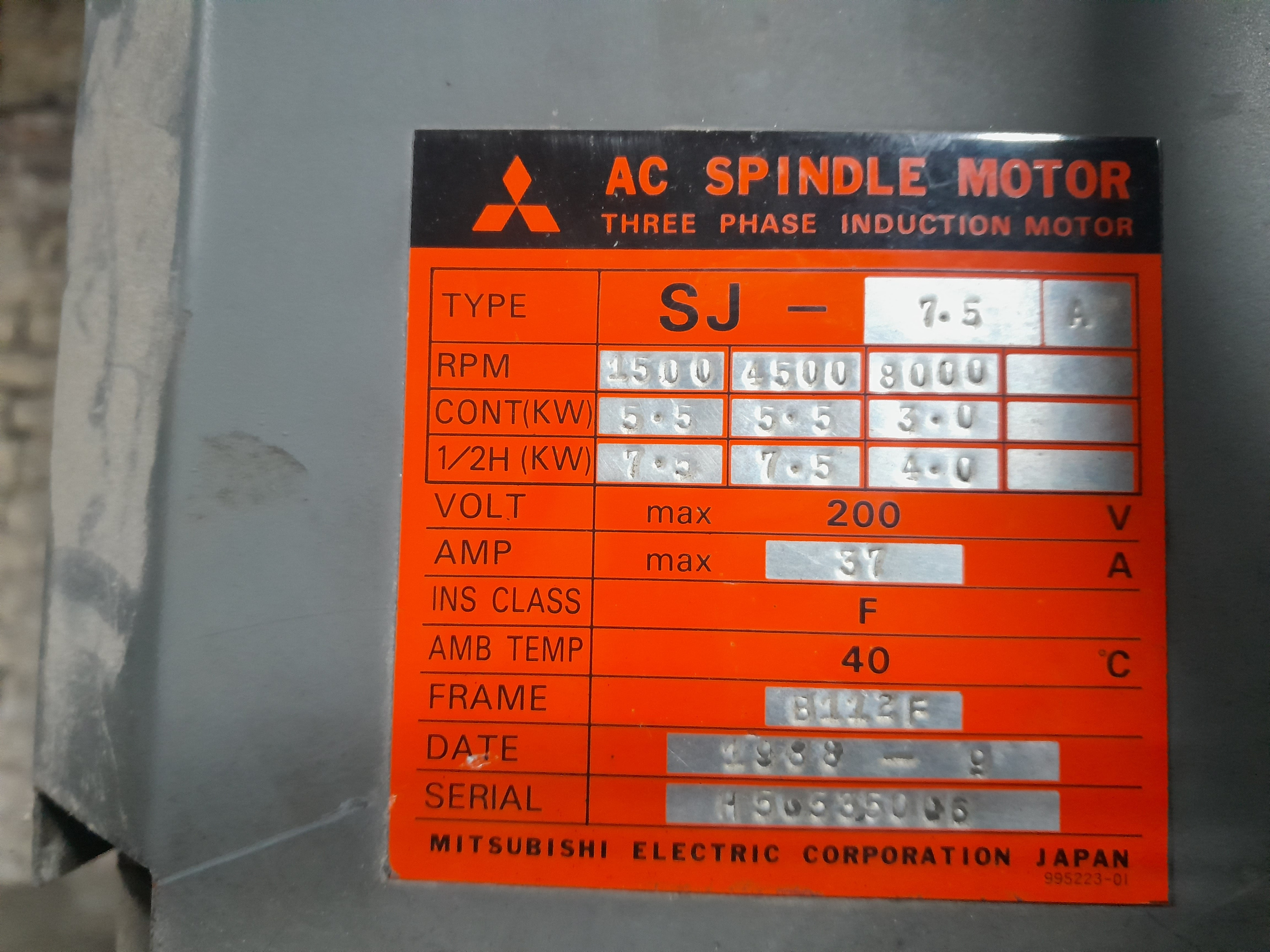

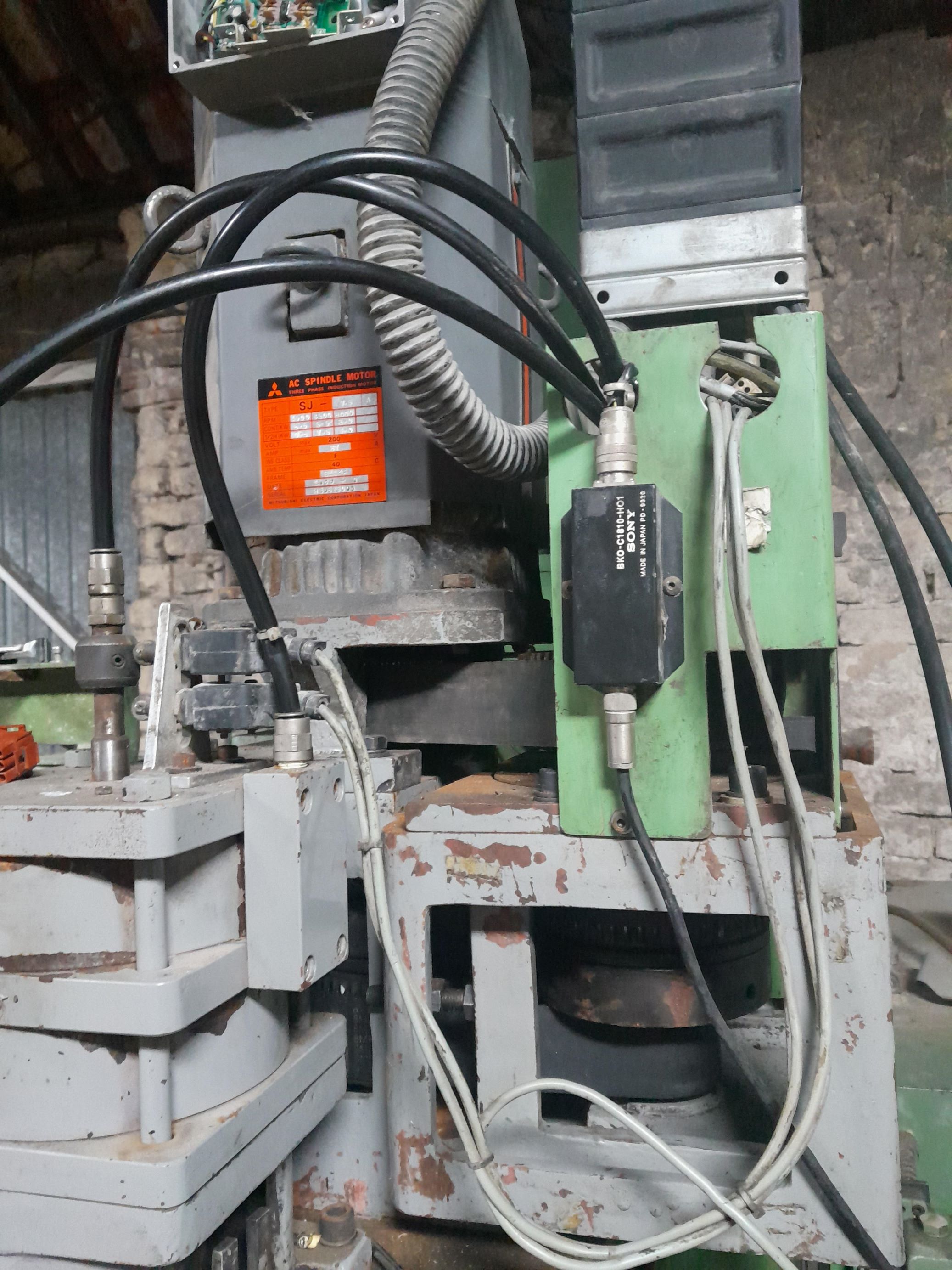

20 Nov 2023 20:12 #286095 by greg23_78
my spindle system also has belts like the attached photo.
I would like to know how you have configured the vfd and pid parameters of your spindle, can you share your config?.
with my experience on hobby cnc, you have to set the vfd according to the motor rotation frequency/speed, with a servomotor do you have to follow this rule? because i have no indication on my servomotor.
Is the PID configuration identical to the PID Tuning procedure like my axes?

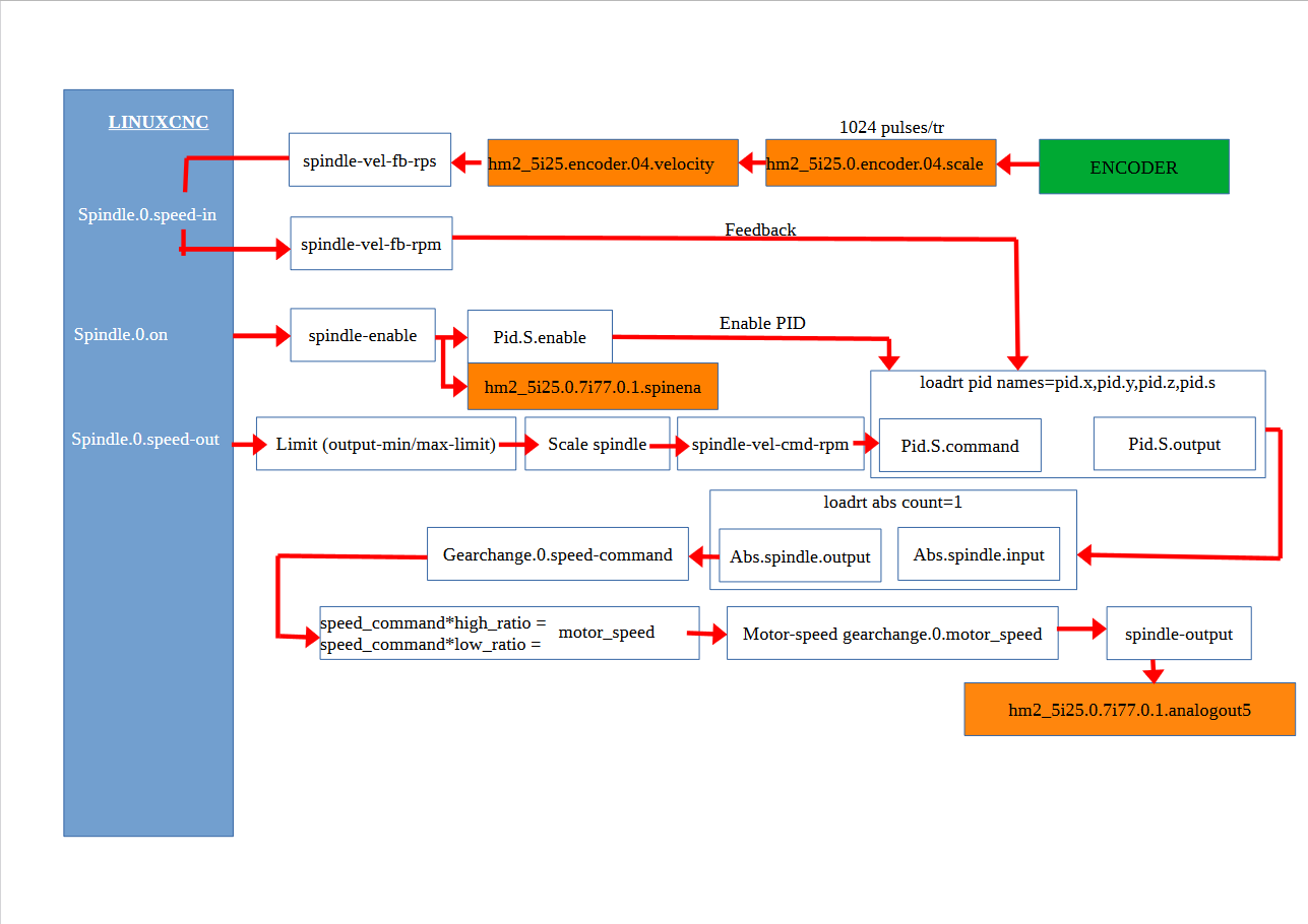

25 Nov 2023 16:05 #286470 by greg23_78
I'm sorry but I'm having trouble understanding your configuration. I haven't tested it yet. I wanted to finish wiring my encoder or buy a tachometer for the time being to get feedback on the speed of rotation with a given frequency to configure the min and max frequencies of my drive.
but i've tried to get the gearchange to work but i'm having problems declaring variables or pins. below is my hal and ini
