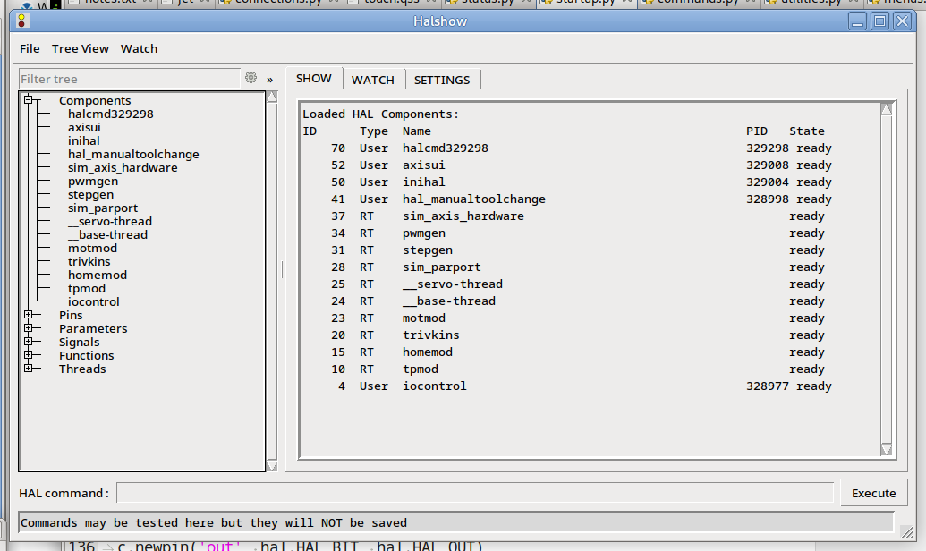

I have a simple GUI and I'm trying to add a HAL pin.
But after running this and opening up showhal I don't see the pin... what am I missing?
I've grepped all the linuxcnc code and searched the forum for a clue but come up empty handed...
JT
def setup_hal(parent):
c = hal.component("buttons")
c.newpin('out', hal.HAL_BIT, hal.HAL_OUT)
c.ready()But after running this and opening up showhal I don't see the pin... what am I missing?
JT

06 Feb 2024 13:43 #292648
by JT
Replied by JT on topic Add HAL Pins to GUI
- JT
- Posts: 1103
- Thank you received: 593
06 Feb 2024 13:45 #292649
by JT
Hmm it shows up even if I don't run that function so I assume it's part of Lcnc.
JT

If I add a test to see if the component exists it returns True
JT
c.ready()
print(hal.component_exists("buttons"))JT
- JT
- Posts: 1103
06 Feb 2024 13:58 #292657
by JT
Chris, thanks so much. You nailed it, c was garbage collected!
JT
