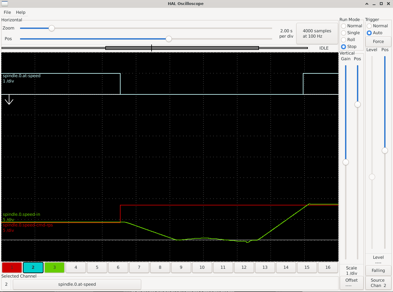

I'm commissioning a retrofitted Deckel FP4NC mill running 2.9.1 and am stuck trying to figure out why axis motion is not being inhibited during a speed change running in auto mode using a hand coded G code file - a warmup routine exercising each axis and stepping up in speed with each cycle of motion. On each change in speed, axis motion continues while the spindle motor stops, the mill changes gear and restarts the motor. The spindle.0.at-speed pin seems to change state as you'd expect going False on the change in speed command and only going True when the spindle is up to speed. The axis moves are G1 moves.

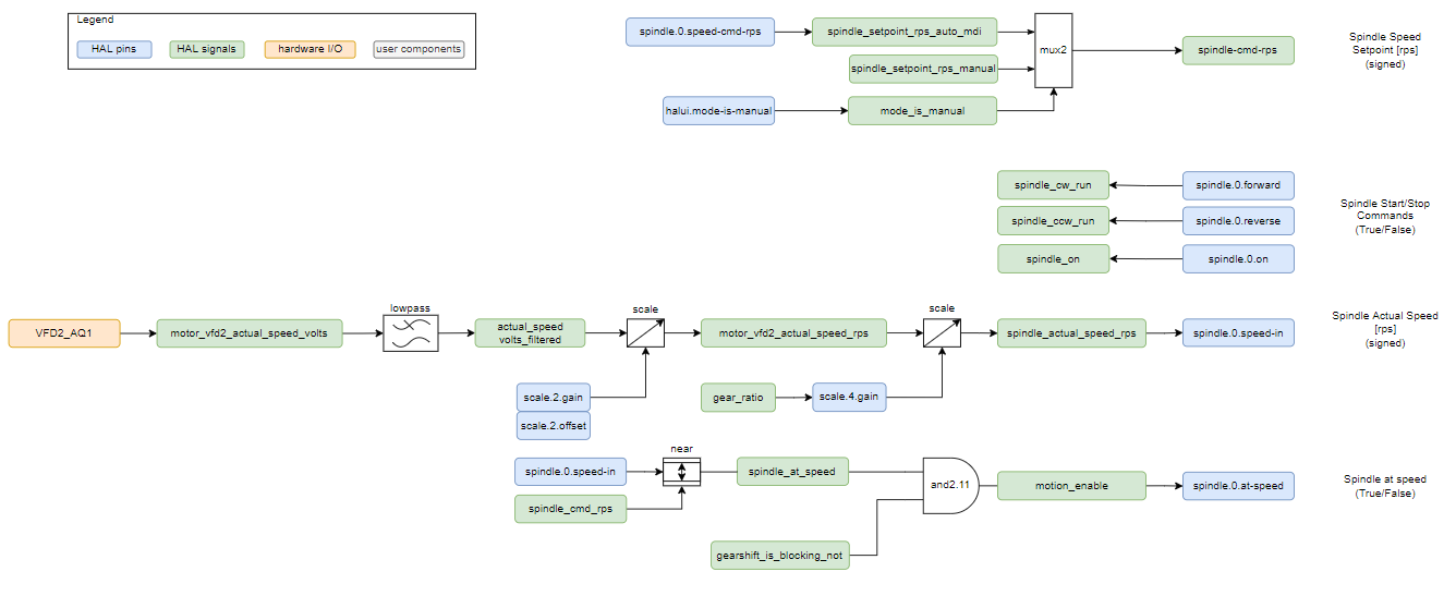

The spindle motor is powered via a VFD and the mill has a gearbox controlled by a non-real-time user component. When the speed demand changes, the user component stops the motor, shifts gear to the appropriate gear, sets the motor speed setpoint via the VFD and starts the motor. There is speed feedback from the motor VFD.
The spindle.0.at-speed pin is set in the HAL file so that it isn't subject to time delays in the user component. There are a few steps in calculating the spindle.0.speed-in pin in the HAL file. The input voltage goes through a low pass filter, a scale component to convert from motor feedback voltage to revs per second, and another scale component using the gear ratio to get to spindle speed in revs per second.

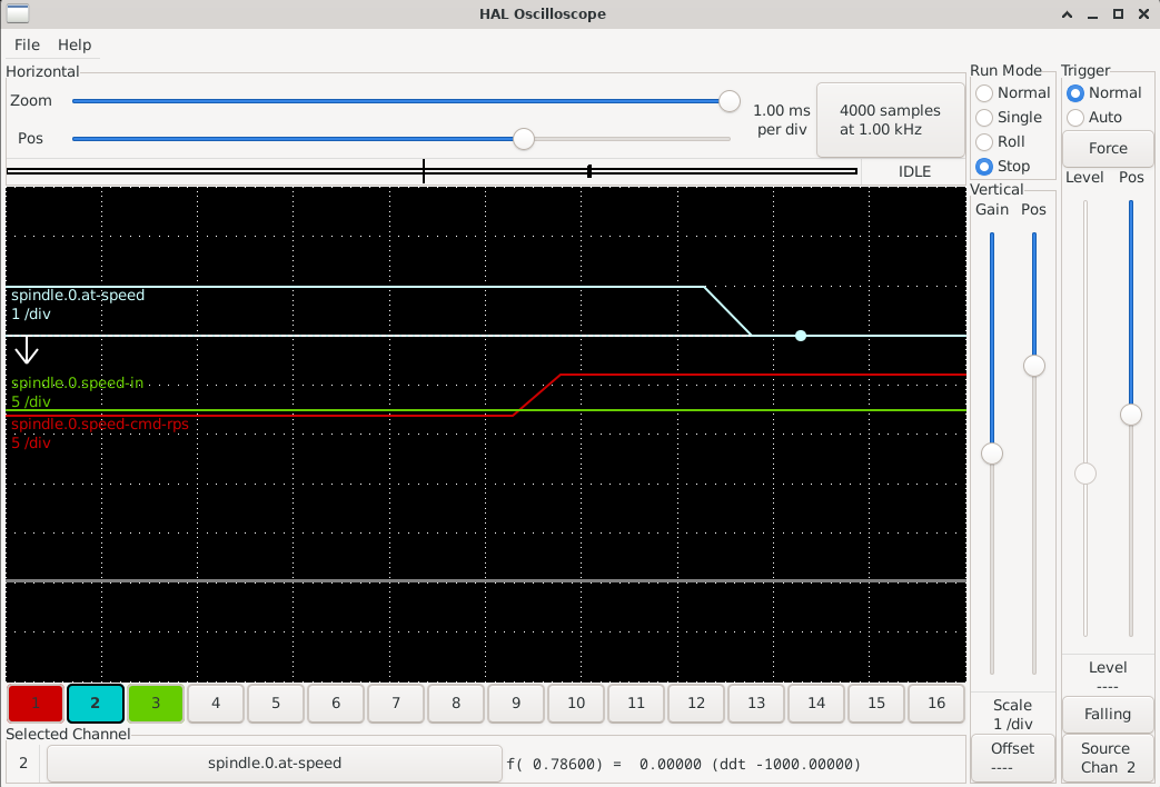

I've attached a diagram of the HAL file along with the actual HAL file, and some screen shots from HALscope, and the Gcode file. There seems to be about a 2ms delay between the change in speed command and the spindle at speed pin going False.

Just speculating, but I wonder if there's a timing issue.
According to the manual, motion will be paused "before the first feed move after each spindle start or speed change"
Perhaps motion isn't being halted if a feed move is underway (even by 2ms) when the at-speed signal goes false.
Just to test, I'd throw a short G4 pause in the program right before the speed change and see if that corrects the behavior.

You may be right about the timing because I tested the code below and works as expected, but I had to put G4 after the speed line.
Code:
G90 G17 G40 G80
S50 M3
G4 P0.1
G1 x0 F1000
S100
G4 P0.1
G1 X100
S300
G4 P0.1
G1 X200
S700
G4 P0.1
G1 X100
S1700
G4 P0.1
G1 X0
M30
