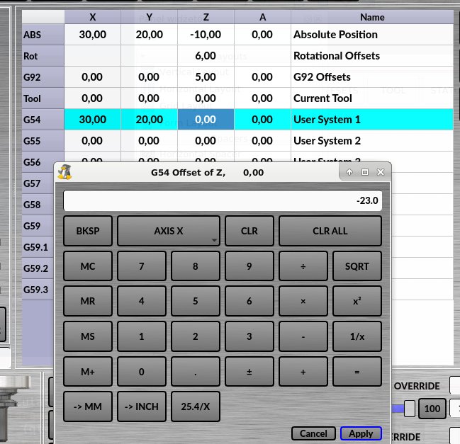

2. The second question is how to set the z-axis offset from the python script.
I need to make a macro that, after measuring the tool, will position g53 z0 in the A-axis rotation axis, as in the screenshot. ?

I used signal because I can't create a new pin to be able to read and change its value. How is it done? , but I'm more concerned about problem number 2.
How to set the Z axis offset from the script.
Where are the offset values stored? In halcmd show no pin displays these values.

I have no problem calling the MDI command from a python script.
I need to do exactly as in the screenshot, only from the script.
I don't know if I need to change the value of some pin or signal, or something else.

To set the G54 offset values from MDI try:
G10 L2 P1 Z-23
To set the currently active offset value from MDI try:
G10 L2 P0 Z-23
G10 L2 P1 Z-23
G10 L2 P0 Z-23
The following user(s) said Thank You: MarkoPolo

Just what I needed, it works. Thanks
I still don't know the gcodes very well.
