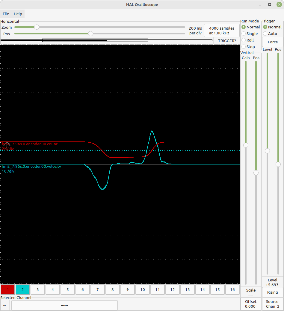

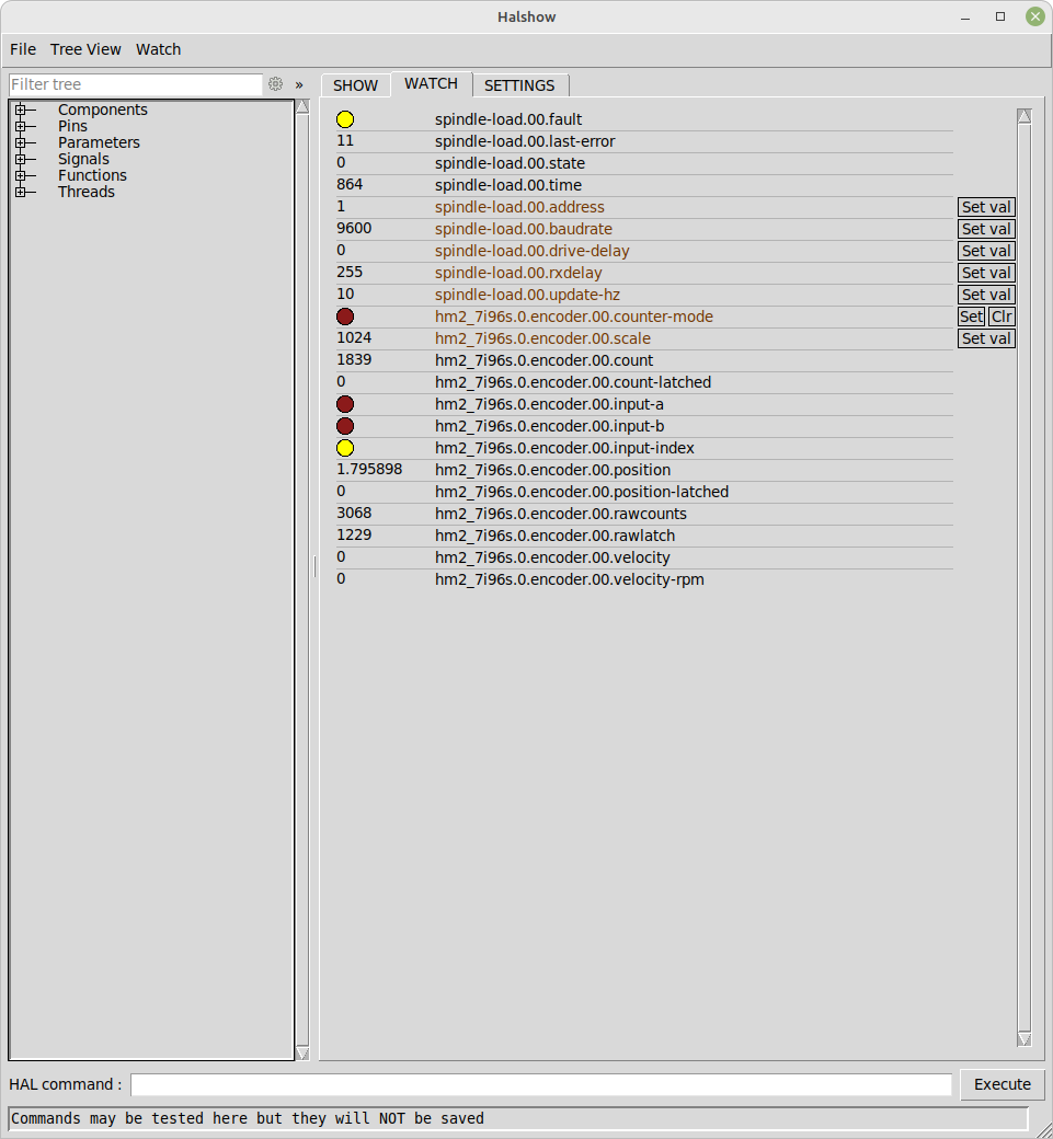

Here is a halshow view: (encoder velocity 0 when not moving)
Here is the encoder behaviour when moved by hand:
Note: you cannot use count mode with a quadrature encoder, this is
an up/down counter mode not a 1x quadrature mode and will miss-count
and give wild velocity numbers when fed quadrature.
Better to use the MPG inputs on TB3 if you want 1X quadrature
