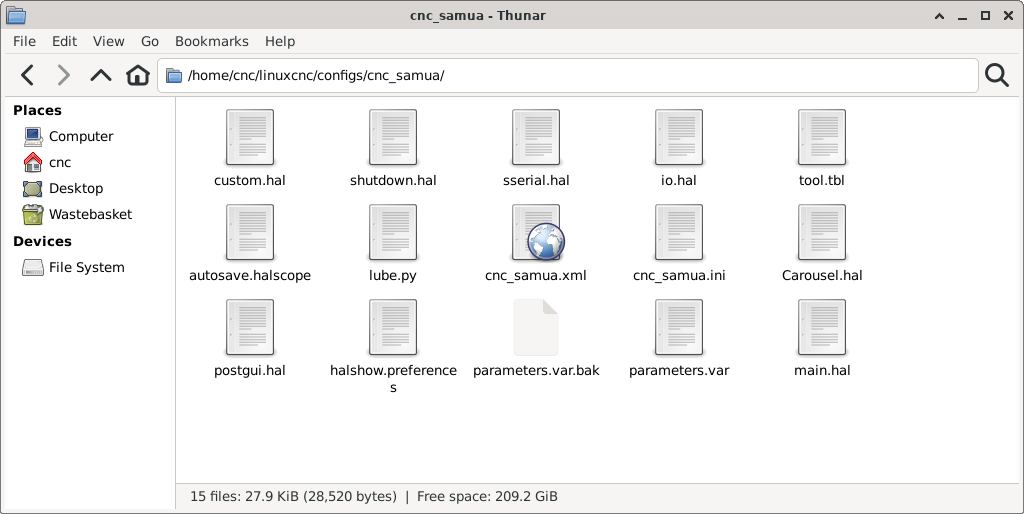

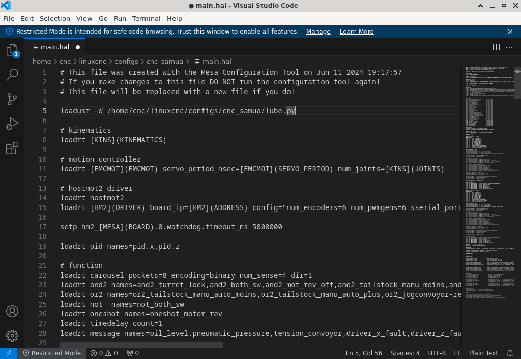

I have a problem using lube.py
I followed the cmorley procedure:
but I still have the problem of "No such file or directory".
I've tried to place it in usr/bin like lubedude's procedure but I'm having the same problem.
my hal filewhat is the cause of this problem?

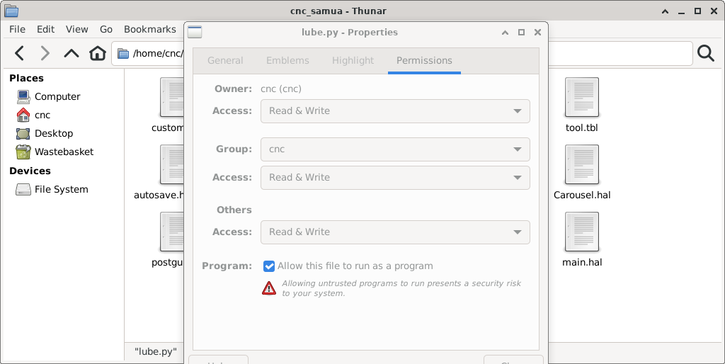

" try this (depending on your file manager the tabs etc might be called diffeent but the process should be the same.
Find the lube.py file using the file manager and right click it.
select 'permissions' tab
select 'make executable' checkbox.
switch back to 'basic' tab.
look for 'location'
copy it to the hal file so it looks like this (obviously you will have a different path):
loadusr -W /home/chris/emc-dev/configs/sim/qtvcp_screens/lube.py
Chris "but I still have the problem of "No such file or directory".

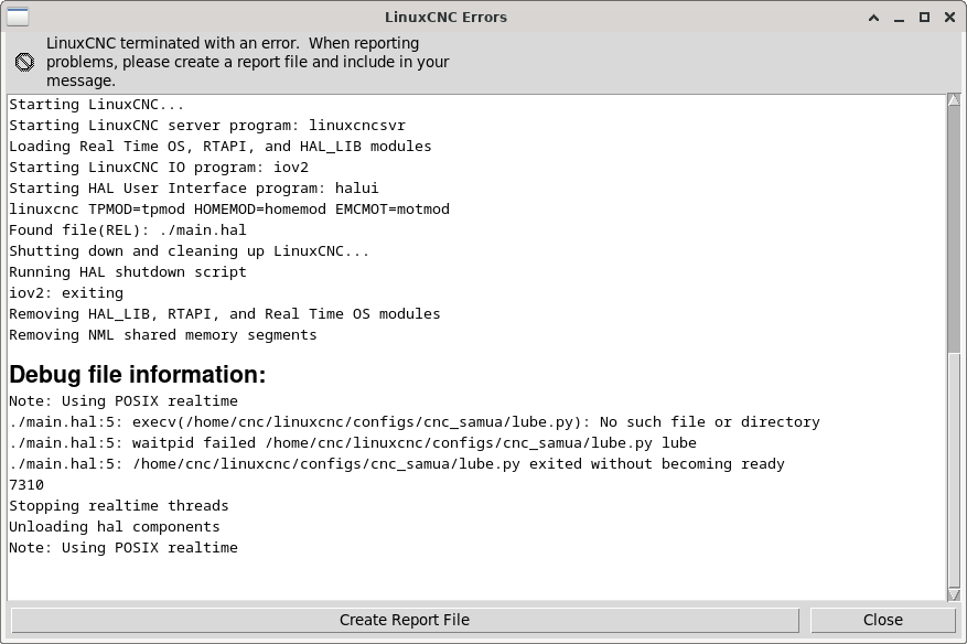

Found file(REL): ./main.hal
./main.hal:5: execv(/bin/lube.py): No such file or directory
./main.hal:5: waitpid failed /bin/lube.py lube
./main.hal:5: /bin/lube.py exited without becoming ready
Shutting down and cleaning up LinuxCNC...my hal file
loadusr -W /bin/lube.pyPlease Log in or Create an account to join the conversation.

27 Jun 2024 18:05 - 27 Jun 2024 18:05 #303918
by greg23_78
Replied by greg23_78 on topic lube.py "No such file or directory"
yes, i have my lube.py in /bin folder and is set in executable
Last edit: 27 Jun 2024 18:05 by greg23_78.

27 Jun 2024 19:09 #303924
by greg23_78

27 Jun 2024 23:18 #303939
Replied by tommylight on topic lube.py "No such file or directory"
Try this:
loadusr -W lube.py
or
loadusr -W ./lube.py
If that does not work, edit the lube.py file and check at the top there should be something like
#!/usr/bin/python
or
#!/usr/bin/python2
and change it to
#!/usr/bin/python3
save, try running LinuxCNC
loadusr -W lube.py
or
#!/usr/bin/python
or
#!/usr/bin/python2
and change it to
#!/usr/bin/python3
