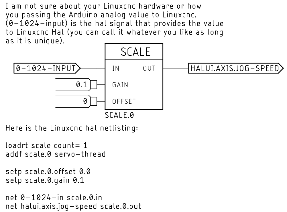

I have an exposed analog from pot value in HAL "arduino.ain.0" (range is 0-1024), and I want to drive "halui.axis.jog-speed" with that value divided by 10
1) Am I best to use mult2, scale or something else?
2) How to implement whatever you suggest?
Much appreciated.

20 Aug 2024 01:54 #308183
by Benb
Replied by Benb on topic Scaling 0-1024 to 0-102
The following user(s) said Thank You: slowpoke

Thanks for that.
The visual (block diagram) explanation works much better for me than the plain text explanation that I initially found.
excerpt from my postgui for anyone trying to figure this out in the future.... this works for me:
# Analog Inputs - Jog Speed
loadrt scale count=1
addf scale.0 servo-thread
setp scale.0.offset 0.0
setp scale.0.gain 0.12
net jog-pot-in scale.0.in <= arduino.ain.0
net jog-speed halui.axis.jog-speed <= scale.0.out
