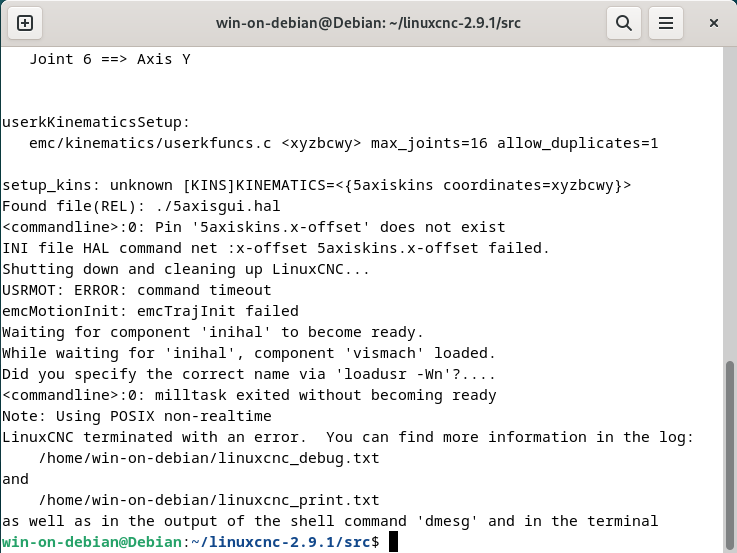

However, after I tried to follow his steps, I cannot reproduce his result. AXIS is no longer able to start the config, and it gives me an error saying that pin 5axiskins.x-offset does not exist.

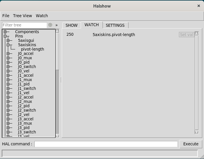

This error was generated from the lines I added in 5axis.ini. Commenting out the four lines I just added in 5axis.ini allowed me to get into AXIS, but I couldn't find the pins I just added inside Halshow (note that pivot-length pin comes with 5axiskins.c by default). So the cause of the error is clear: the pins didn't get created at all.

you also need to call the 'hal_pin_float_newf()' to create the pins:
So after this:
add this
So after this:
result = hal_pin_float_newf(HAL_IN,&(haldata->pivot_length),comp_id,
"%s.pivot-length",kp->halprefix);add this
result = hal_pin_float_newf(HAL_IN,&(haldata->x_offset),comp_id,"%s.x-offset",kp->halprefix);
if(result < 0) goto error;
result = hal_pin_float_newf(HAL_IN,&(haldata->y_offset),comp_id,"%s.y-offset",kp->halprefix);

in the lines below, you are actually creating a variable to hold your data in program memory.
struct haldata {
hal_float_t *pivot_length;
hal_float_t *x_offset;
hal_float_t *y_offset;
} *haldata;
You need to expose that addresses named x_offset, y_offset, pivot_length to hal layer, this means exporting pin. As aciera said, you can use hal_pin_float_newf function to export it. You can also use other functions to export it, they are declared at src/hal/lib/hal.h file.
This exporting process works like this:
1- You have a struct in your program memory and it is only for your program, not for other programs.
2- With this exporting functions, you are sharing your program's memory with other programs. You can consider it like giving a permission to hal layer to access your program's memory. You are registering your program's memory to public area.
3- Afte exporting your pins, you are giving ability to use that pin names in hal layer appropriately. for example, if you use this code block,
"%s.pivot-length", "component-name");
it means you are exporting haldata->pivot_length memory area to hal layer with name component-name.pivot-length. After that, you can use it in your hal file with this name.

And it is good to remember, in these lines below:
struct haldata {
} *haldata;
Your data is a pointer, and it is NULL pointer at the first time. You need to use hal_malloc function to export your data to hal layer before exporting pins.
